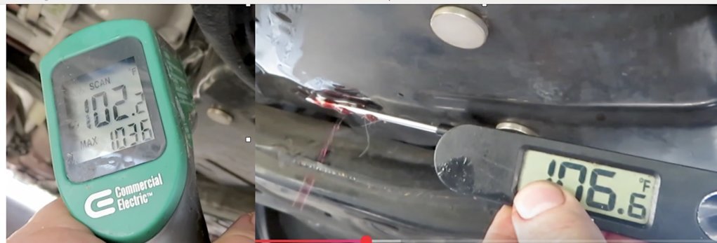

    Forget the geeky jumper method. Manually measure fluid temp; i.e. shine infrared temp gun at tranny oil pan. On a 60-80 degree day you'll get a reading that's about 2 degrees cooler than actual fluid temp which is close enough. Then when excess fluid is draining you can manually verify its temp. qqqijoqq.jpg

    If it's hot out you will likely need to let it sit overnight for it to cool down enough to get into temp check mode (temp must be below 95F). Otherwise check the temp manually, needs to be 96-115F to check.
