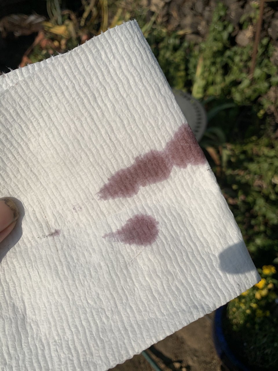

    6EC9EE53-93C0-4DD0-A678-1C95C594E795.jpg Hi guys does this color look okay ? Thanks

    That’s red wine ! What are you trying to pull on us?

    Is that a bad sign ?? I’m kinda worried lol

    It looks completely fine and normal.

    Open a bottle and put some on the towel next to yours

    Looks ok to me.

    Thanks for the replies! I’m thinking about doing a drain and fill it back up through the dipstick, would you guys recommend? Or should I just leave it ? I have the 2.7 4 speed auto so I’ve read I can add thru the dipstick. Truck has 95k miles and has a tow hitch so the previous owner must have been doing some towing

    Looks clean to me , has no clutch residue discoloration

    Drain and fill. Drive 2500 miles, repeat. And one more time.

    Yes, I’d do a drain and fill.
    For no other reason than mileage and maintenance. Plus, you have a dip stick. You are luck:thumbsup:

    Reality. You can not judge the condition of the oil by color. Sure, when the oil is totally consumed or scorched, it will turn dark.
    Just go ahead. Do the drain & fill.
