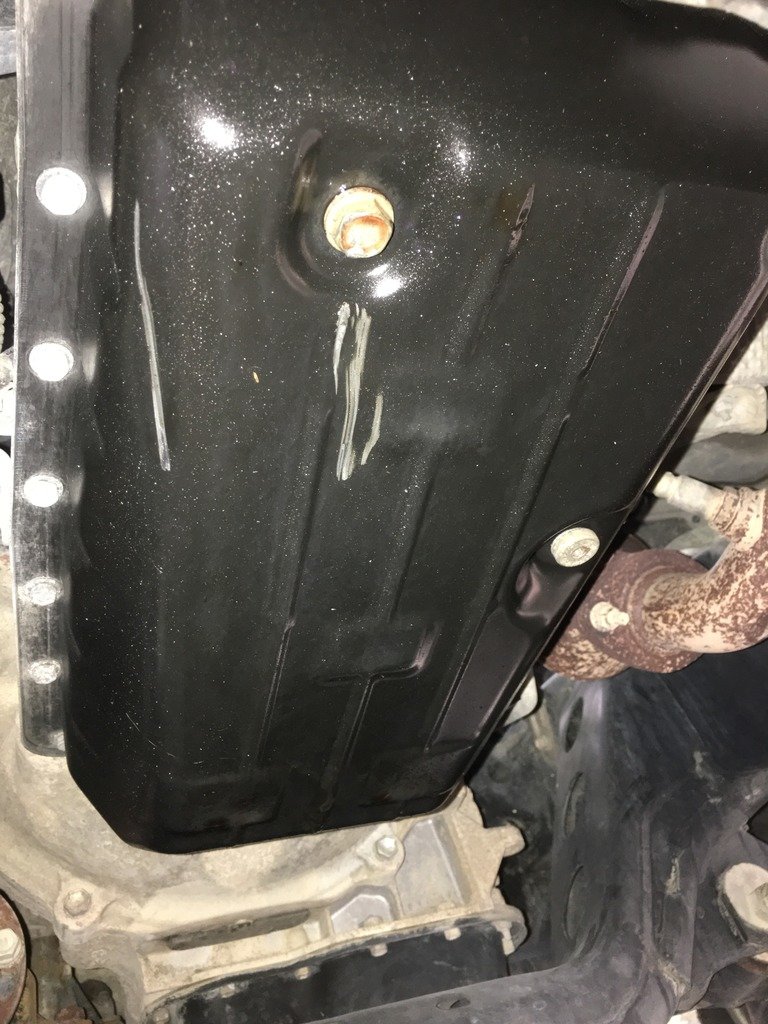

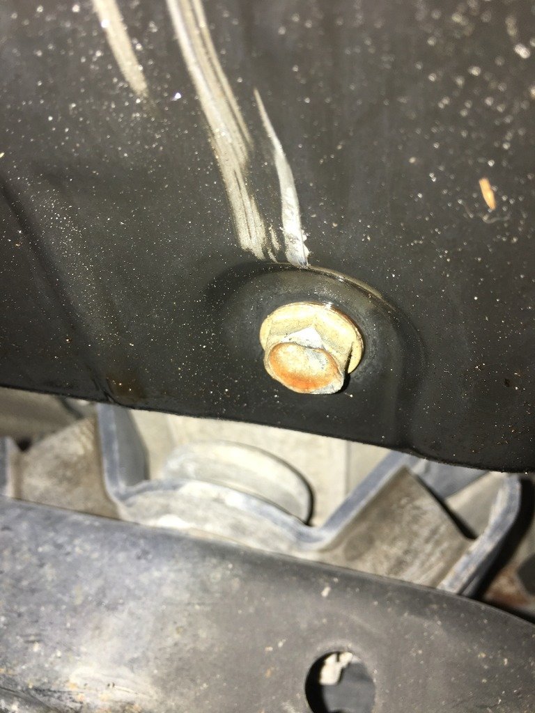

    As you may or may not know, I had an accident a few weeks ago where I was run off the road. Everything was fixed and good until I was changing my oil last week. When under the truck, I found out that something I had run over in the process dinged my transmission pan and drain bolt and it was weeping fluid. Not enough to make drips in the driveway but there was residue on the pan.
    I contacted my insurance company and they agreed to cover it under the main claim so I got a new pan and bolt as well as a fluid drain and fill (since you can't remove the pan without losing fluid).
    The dealership said they used about 6 quarts of fluid to fill the transmission but I don't know what the overall capacity is. So here is the catch, I was due to do a fluid swap in the near future anyways. Since they did not technically flush the system, would 6qts of new fluid be enough to call it good or should I go back soon and do a proper flush and refill. It is about a $275 service so I would prefer to be able to wait until the next service time.
