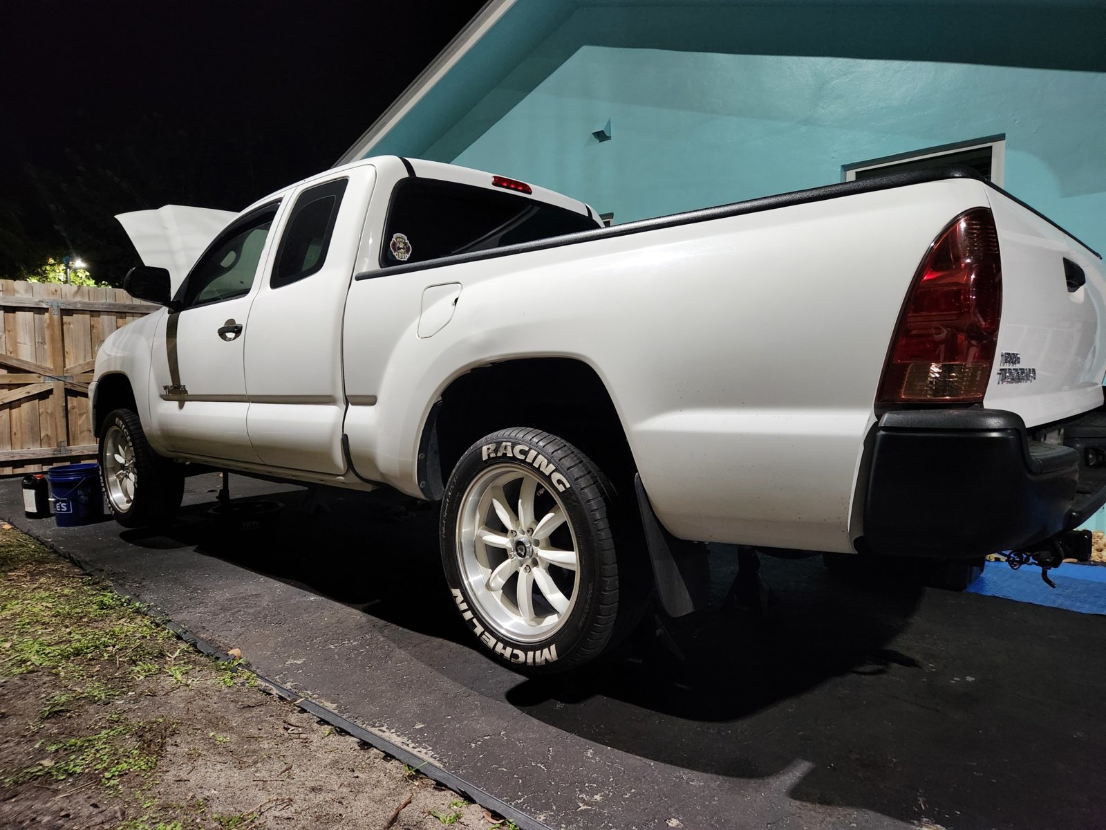

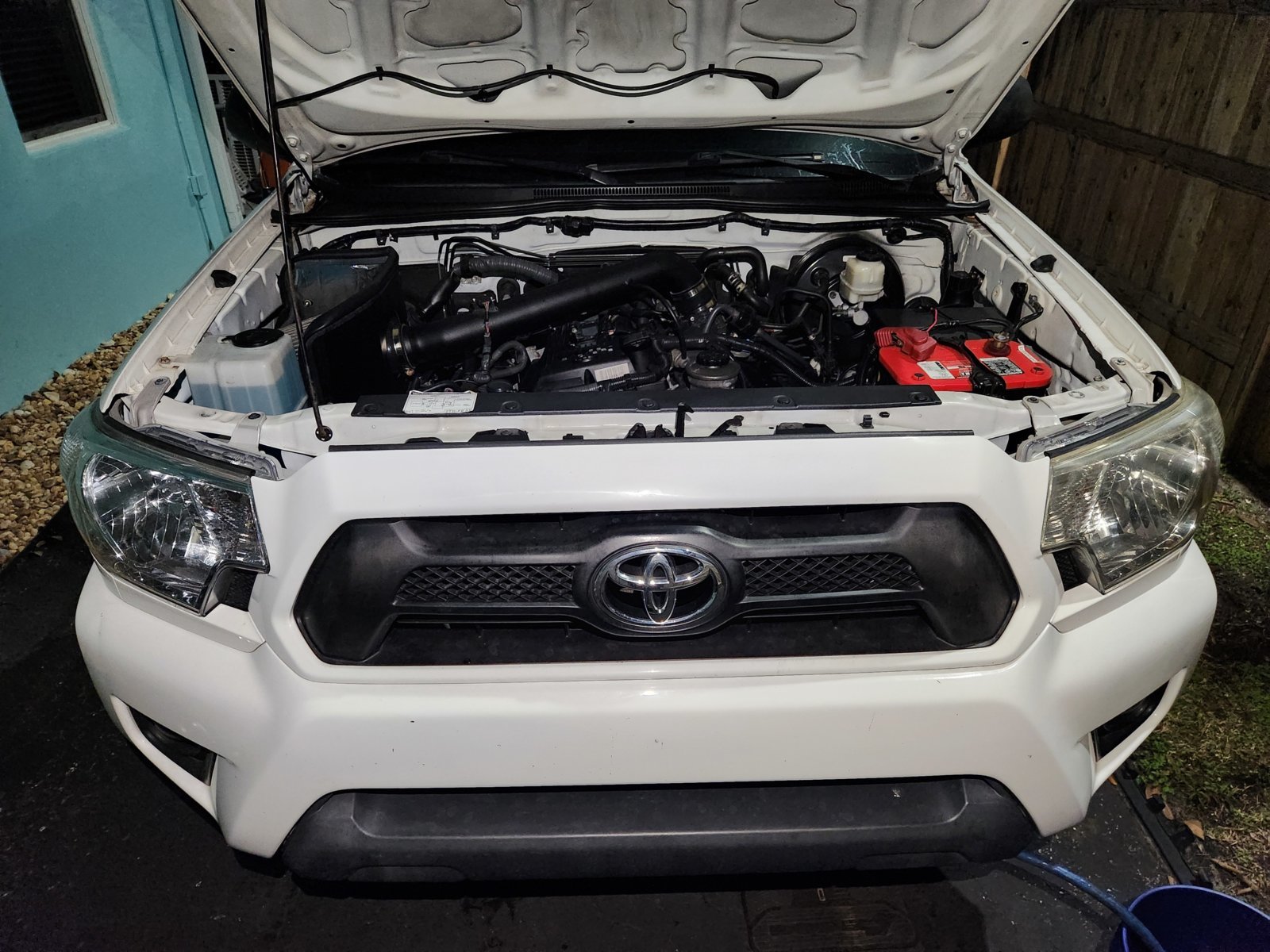

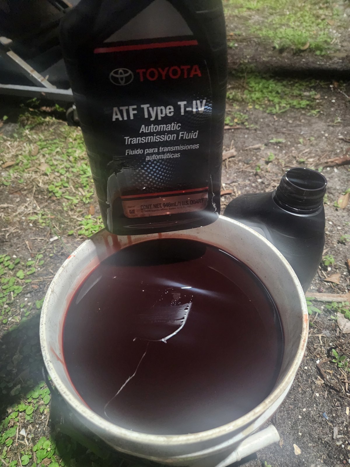

    I just did a drain & refill on my 2013 Taco Base model 2wd with the 2.7ltr & 4 speed automatic transmission. I went to the local Toyota dealership & bought 4 qts of the Toyota T-IV fluid for about $35 . I have just hit 60K miles. The Toyota tech said "just drain & refill, you don't need to change the filter unless you really want to". I don't pull anything & don't beat on her all the time, lol. I'm also flushing the coolant with Toyota's red concentrated antifreeze. I always use distilled water even to flush it instead of city water. I've been a marine diesel technician for over 30 years & that's how we've always done it. I've seen what non distilled water can do to a cooling system. I've already sucked out the power steering & brake fluids (bled brakes starting with the left rear) & refilled with new (DOT 4 for those racing days!) I still need to do the limited slip diff & clean the throttle body. Take care of your Taco & she'll take care of you!!
    E-Tacoma13 and JGO like this.
