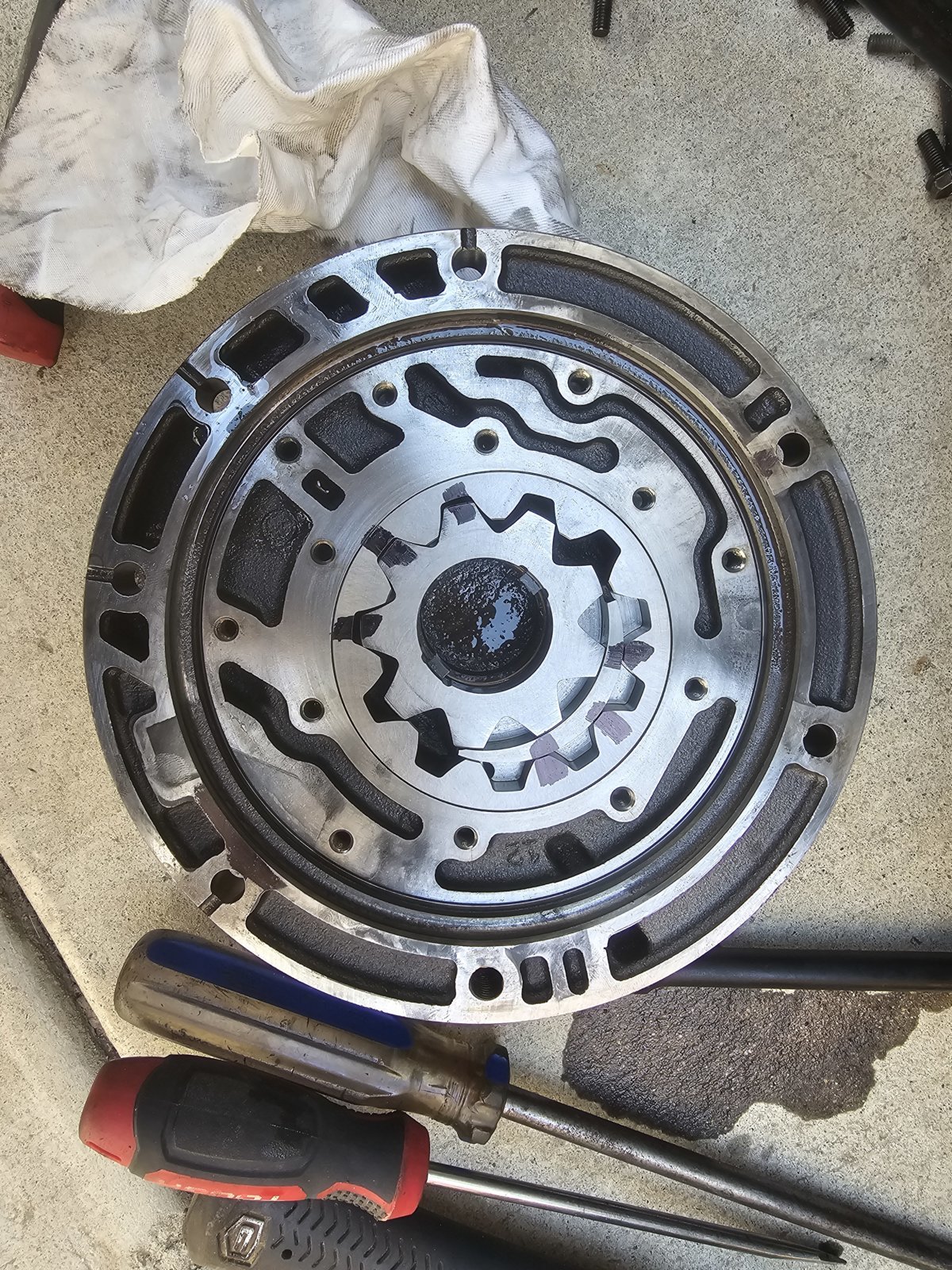

    I took the transmission off to check the fluid pump thinking it might be damaged. It looks fine.

    Where's the inner rotor?
    HondaGM likes this.

    Any pictures of what this looks like?

    Predator tube steps, Ranch Hand grill guard, Magnaflow CatBack exhaust, Toyota tool box & bed mat, 2LO Module by @Up2NoGood, Rearview Compass/Temp Mirror, Tune by @JustDSM.
    Oh nvm it's in there, it looked like it was missing but I see it now in the first pic.
    I'm not sure then, I'm not a transmission guy. I know a little bit about them, hopefully @gearcruncher will chime in with something.
