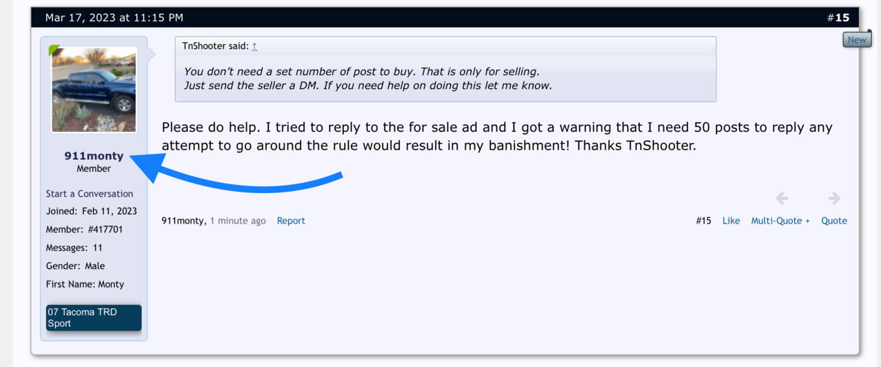

    Please do help. I tried to reply to the for sale ad and I got a warning that I need 50 posts to reply any attempt to go around the rule would result in my banishment! Thanks TnShooter.

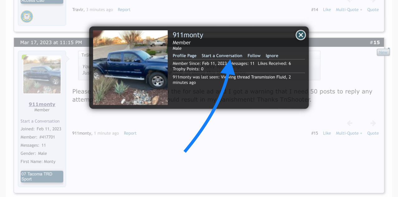

    I used you as an example.
    You’ll need to go to the for sale ad and click on the sellers name.
    Then click “start conversion”
    Again, I used you as the example.
