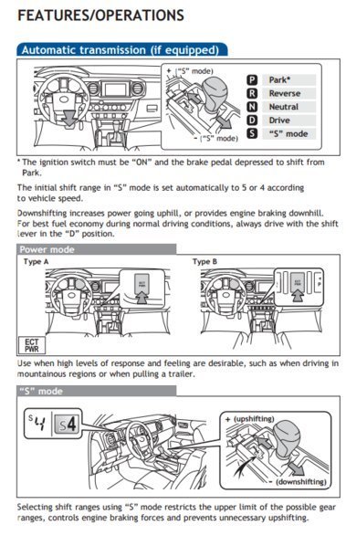

    Owners manual refers to it as S mode, used to prevent unnecessary upshifting if desired.
    I use it to limit access to 5th and / or 6th if I feel like the truck cant decide which gear depending on speed, slope or headwind.
    It also says use D when best fuel economy is desired, I use that too.
    It doesnt say use one mode only for everything.

    Yea, I’ve read that section of the manual several times. I’ve also used it when trailering my ATV’s.
    I really think Toyota should have stayed with a five speed. Sixth gear is almost useless. Or, they should have gone with an eight speed or something. I guess they felt that would have been crazy on an offroad truck.
    The six speed auto definitely isn’t their finest work.

    Found this below, now it makes sense. I guess my Butt Dyno needs calibrating. I essentially downshifted into 4th gear and then bumped it up twice into 6th and all was good as it stopped the back and forth between gears, I was using Cruise Control. It did downshift again on it's own while in S, I gassed it and it went back up. We're talking an 8 mile, 6% grade. It sounds like a better option would have been to use the ECT in D. I look forward to trying that next time. That video posted above is pretty funny, at this point, I'm going to say yes, you need to learn to drive them, lol.
    "S stands for Sequential. Unlike most other cars selecting gears in S mode doesn't actually mean you're selecting that gear (unless you set it to 1). It just limits it to that gear, but it will eventually change gears depending on speed etc. Really doesn't change the throttle mapping or shift points like it would in a typical sport mode in other cars. That's why Toyota can't call it Sport mode."
