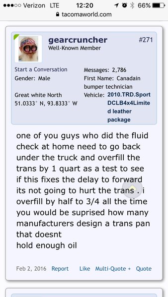

    I would be willing to bet there is strong case of a mis- diagnosis here .
    You have " Two "of the classic low on fluid symptoms similar to a bunch of the new 2016 trucks and here we have a transmission assembled with incorrect tolerances that was tested at the factory and worked fine ?
    It would be nice to see the paperwork on this one to determine what tolerances the technician is reporting as the problem .
    You can watch on the techstream how long it takes to fill the forward clutch with oil .
    The error code on the computer for a slipping forward clutch will be similar if the transmission is low
    If the technician is stating that it takes too long for the forward clutch to fill with oil when its, cold as the problem , I would be willing to bet the transmission is still very low on fluid .
    Regardless , its being repaired under warranty .

    I second @gearcruncher . it looks like low fluid, and sounds like your low fluid condition damaged transmission.
    I would ask for new truck, you have brand new truck that will have transmission swap in car fax. Dealers will lowball you on resale.
    To others, you folks understand the concept of oil ? Right?
    If you drive truck with low fluid condition you will damage transmission so just adding fluid is too late.

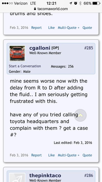

    But didn't we have a guy in another thread who purposely overfilled his fluid and still had the issue?

    There was mention of this in another thread but that was
    when there were issues with the proper fill procedure . I am sure
    he would have posted back by now if his problem continued .

    It takes long time to purge all air from the system and get transmission to shift properly. This is not like A750F/E transmission, those 6 speeds have thermostat which simply is trapping air in system. (even if you set thermostat to fully open during measuring procedure)
    It takes long time and quite an effort to get rid of all the air. Trust me on this one, once you get air in the system it is absolute pain in the @ss to purge it all.
    So somebody filling transmission and not getting results right away is not surprising.
    It took me quite a time to get my AB60 correct, no thanks to retarded Toyota and their techs. Because it takes time to set correct level, no dealer can get that right except from factory. Because either you know how much fluid you need to put or you need to keep filling until all air is out.
