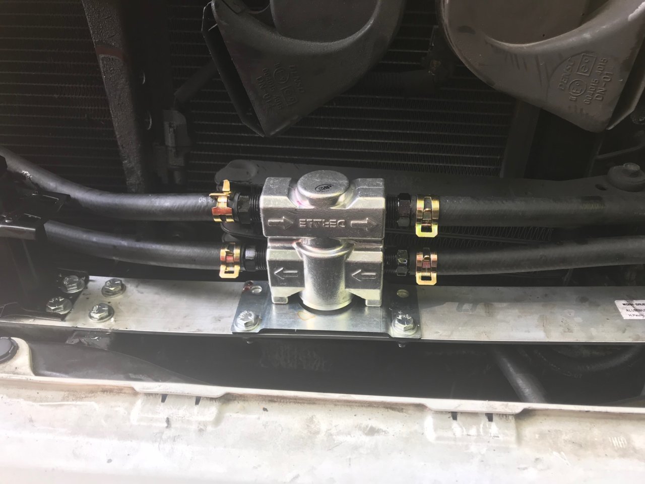

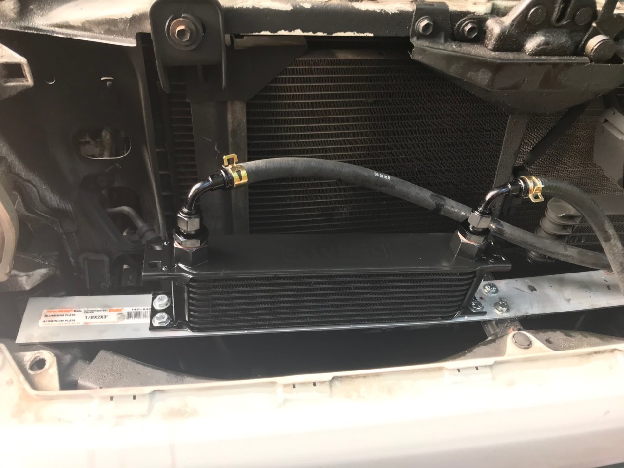

    I run the atf thru the OEM cooler , magnefine filter , derale 180 thermostat , stacked plate additional cooler and then back to transmission. Works great
