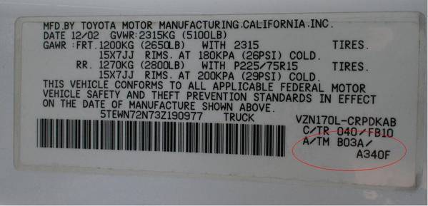

    There is also the information sticker located on the inside of the drivers side door jamb
    In my case it's the A340F
