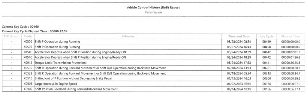

    Also took mine to the dealership today. Service writer had the shop foreman look at it.
    - Said no codes.
    - Could not reproduce the hard shift issue. To be fair the issue only lasted ~500 miles (1600 - 2100 mi, now at 2600), I made them aware of this. Said this was the vehicle learning driving habits. I did confirm as someone else stated that the truck shifts down early in Tow Haul mode causing RPMs to spike and you to jerk forward. This is fairly consistent and likely by design (transmission braking?).
    - Said that his new 24 Tundra does the same jerk between drive modes and that this is normal.
    - Said Toyota may tweak the shift characteristics in a future update.
    - Pulled some internal transmission logs and blamed me for “shifting during fore / aft movement”. I assure you I make a point to never do this. Since I didn’t take ownership of the truck until 7/18/24 @ 17:00 or so, none of those logs before 8/24 were me.
    8/28 - No idea what this event is
    8/27 - No idea what this event is
    8/24 - I did rev the vehicle in P twice on purpose, no idea what the transmission torque limit would have been for
    The issue has been reported to Toyota. I will drive the truck like all is normal. If the transmission does anything crazy, it has been documented.
