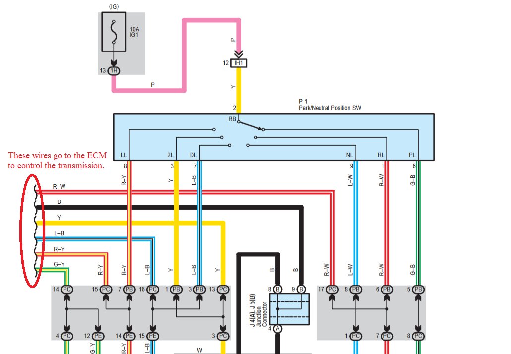

  11. Mar 18, 2021 at 7:39 PM
    Jimmyh
    Jimmyh Well-Known Member
    May 16, 2012
    #78991
    14,287
    SC
    2012 Prerunner SR5
    See the drawings below and verify the voltage at the yellow wire pin # 2 on the park neutral safety switch connector on the transmission. And if you do have 12 volts there you can then verify you are getting power to the wires at the ECM Connector for each position when selected.
