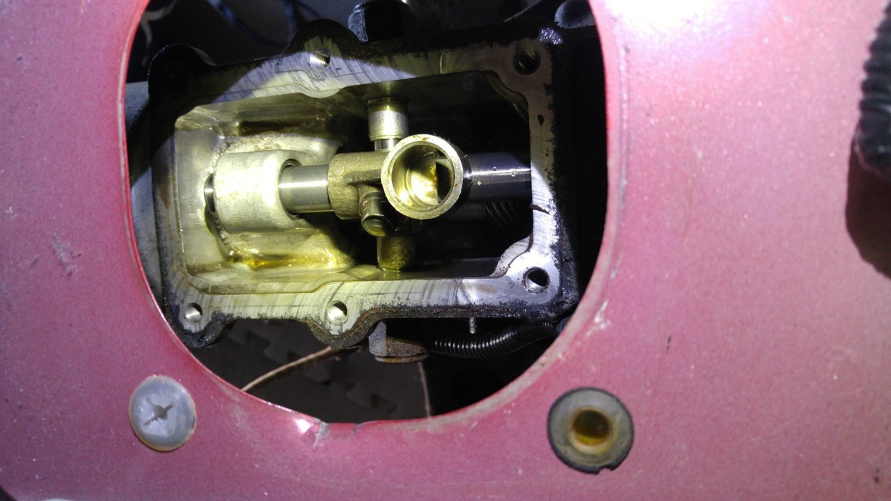

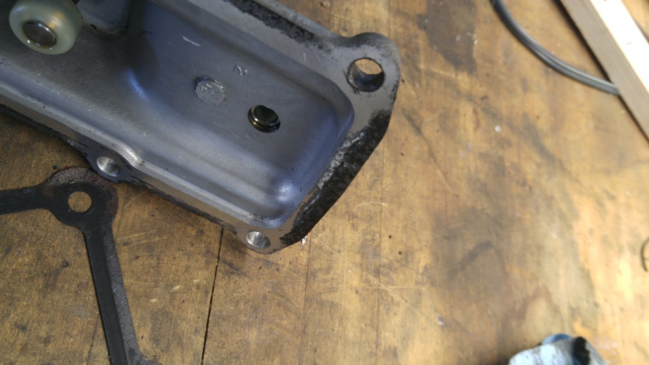

    Found the leak!
    It was coming out the top cover. More precisely, the seal between cover and housing had failed due to corrosion. The factory seal is metal with a rubber coating on both sides. The steel was rusted, which in turn swelled. Then the aluminum on the cover started to corrode. Been doing this for sometime too. Found evidence its been slooooowly oozing by the build-up of road-grime covered oil on side of transmission tunnel. It finally opened up enough to make itself really known.
    Someone has been here before too. One of the 6 bolts was mismatched, and all way over snugged. Plus the floor pan around the opening was dented from someone prying against it. And I do not believe it was the dealer that did new frame, as I just cannot see why they would have needed to remove shifter. There is more than enough room for it to drop clear when body was removed.
    Regardless of the how, in the end an easy fix in about an hour.

    I the top photo, the rear-most end is on the left. The housing itself was largely corrosion free.
    Bottom photo is rear of cover. All that black & white stuff is corrosion. Sanded all smooth with 400 grit. Cleaned everything, applied gaket sealer to both surfaces and reused factory seal. I decided to reuse seal as it was actually in decent shape. It was the exposed areas around the bolt holes that had rusted the worse. The sealing surface was still sound. Really the aluminum appeared to be rotting faster than the steel.
