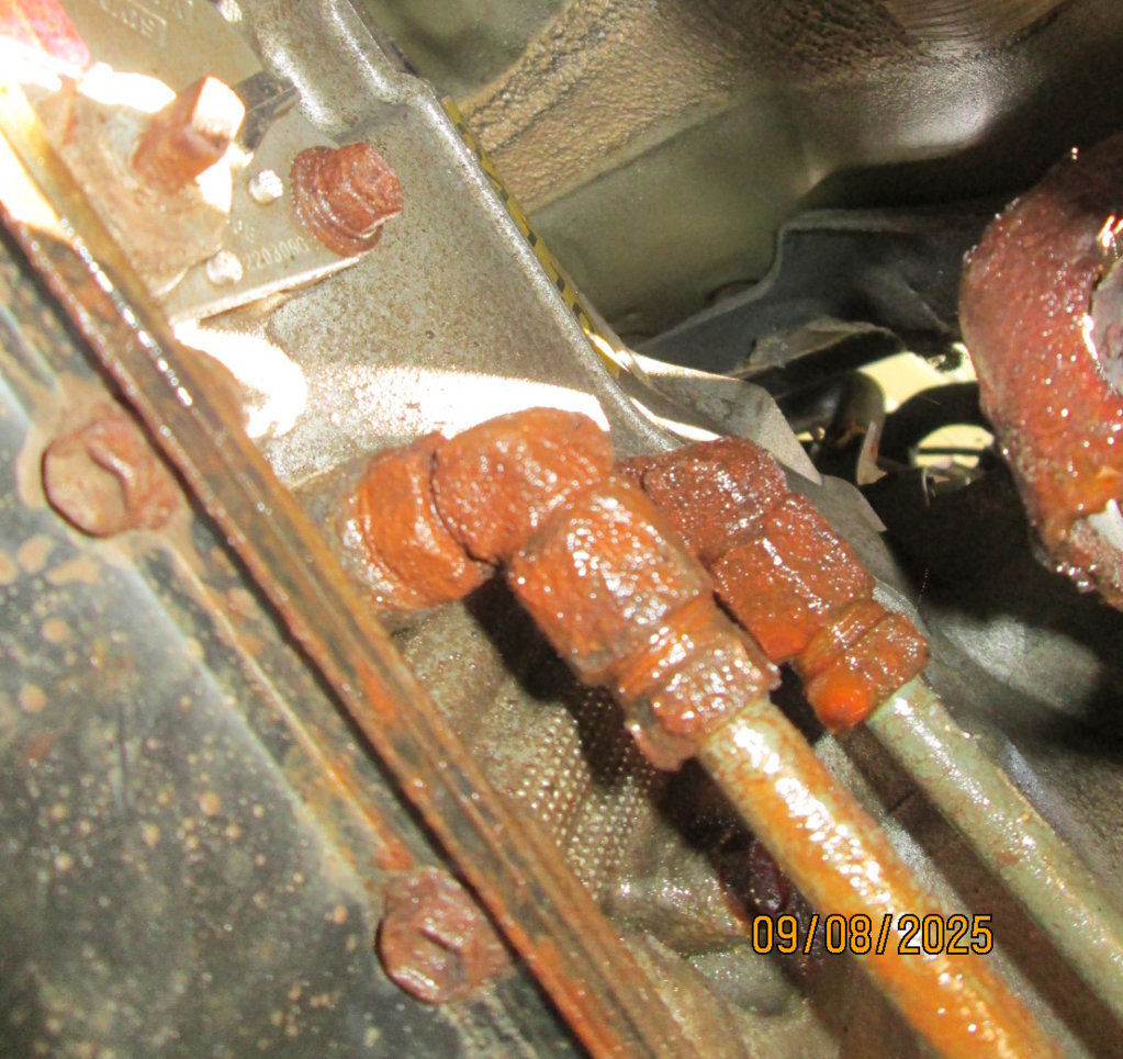

    I'm attempting to replace the tranny lines to the cooler which are leaking. Easy, eh? Maybe if you have an AZ rig but not so if it looks like it's been on the bottom of the North Atlantic for 50 years. My hold up is where the lines go into the tranny fittings. Before I go full destructive and cut the tube to put a 6 pt. 17mm deep socket on it, is there anything else that comes to mind?
    Photo is of the fittings marinating in PB. I wire brushed them and ran dental picks to clean them up.

    I’d try the 50/50 ATF and acetone mix. Let it soak for a day or two, reapplying a few times. After that, hit it with some heat and very slowly work on cracking the fittings loose. As soon as they budge, work some more of the ATF/acetone in and then tighten them back down a bit before backing them out further. Keep repeating until they come all the way out. As far as the fittings that screw into the transmission housing, I know they look rough on the outside, but the threaded portion that screws into the transmission uses a washer seal. I’d be willing to bet the threads themselves aren’t too bad once you get them out.

    But yeah... This looks like a time when Vice Grips might be the only choice, those are pretty crusty.

    Thanks for all the input. I got them off. After trying for the longest time in being careful not to round the fittings off, I decided to go the destructive route. I cut the line and put a 6 point socket on it and they came of surprisingly easy. Installed the new stainless lines and tomorrow I'll check for leaks. Being that I did lose some fluid, would it be advisable to add a quart before I check for leaks and then go through the fluid level procedure?
