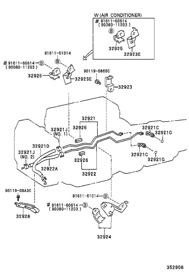

    Long story shortened I gifted my 2003 PreRunner to my brother in law who had his car repo'd. He evidently ran the truck into the ground, blew a head gasket, kept driving and locked up the engine.
    His wife bought a used engine and when he got it back from their mechanic a union at the transmission was leaking. I don't remember it leaking the last time I saw it. The mechanic who installed the engine swears it was low on transmission fluid and this part was leaking.
    My BIL brought it over yesterday and I cleaned the area and nothing was leaking. I tried to get the transmission line off but due to very limited clearance and it being so frigging tight I couldn't budge the nut holding the line to the union. This was going to take a narrow jaw crescent wrench and stubby off set 19mm wrench. Besides I was taking my wife out to lunch that day so didn't have the time to keep working on it. Anyway the transmission was 1 quart low and my BIL swears he observed the fluid coming out of the union fitting. He says it leaks a quart every day. He does drive about 100 miles a day to work.
    The mechanic also said it was an intermittent leak and he needed the union part to repair the leak. I can understand the O-ring being replaced but not the union. I can't understand why a union connection would leak sometimes then not unless he cranked down on the tube nut fitting (17mm) with out holding the union body (19mm) and caused a hair line crack.
    Any ideas out there?
    32921C
    UNION(FOR OIL COOLER TUBE). INLET; NO.2; OUTLET
    RZN19#,TACOMA (VZN150),195; AUTOMATIC TRANSMISSION
    RZN19#,TACOMA (VZN195)
    32921G
    Automatic Transmission Oil Cooler Hose O-Ring

    A quart a DAY??? That's not even a drip. You should be able to sit there and watch it stream out and make a puddle on the ground.
    I'd clean it up real good, and go take it for a drive. If it's leaking a qt a day, a 5 minute drive should have more fluid all over the place.

    I don't think a hairline crack that wasn't obvious would drop a quart a day, though. I wonder if it was just a quart low when he noticed the leak?
    It's plausible that the leak only presents when it's being driven (when trans is in motion). Hopefully if he comes back in a day or two you'd be able to see an obvious sign of a leak.
