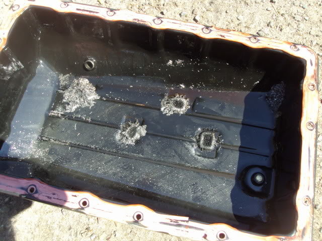

    Yep, here's the magnets doing "nothing".....:p

    I'm not a trans mechanic but that doesn't look very good. OP how about some of this. I'm sure you could find some at the local hardware store.

    that looks more or so like some one doesn't change there oil like they should...

    I'll take that with a grain of salt...
    I'm pretty anal about routine maint., that said my trans failure has little or nothing to do with fluid condition, thats not tranny "flash" in the pan, its metal, & lots of it, we're not talking shavings, we're talking chunks.. chunks of gear teeth, etc;..

    Not flash or dirty fluid(well its dirty now)

    Make sure theyre in there!!! They do exactly as pictured above. Trapping metal shavings is a pretty big deal in a tranny. I also have a magnapure inline transmission filter on my truck and an auxillary transmission cooler. 234,000 rough miles and still works great
