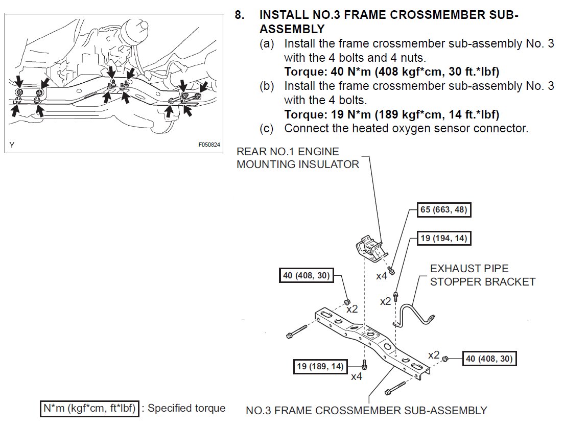

    Thanks for the diagram.

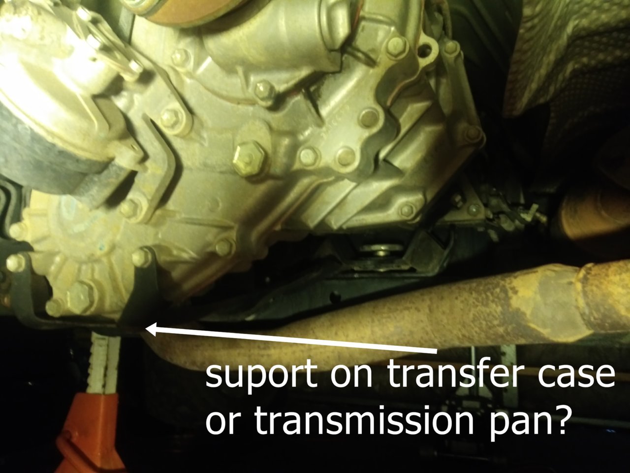

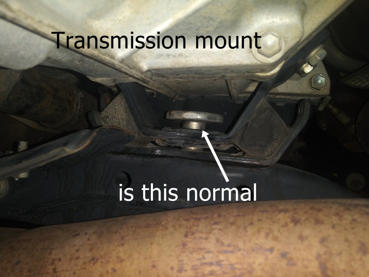

    The dealer told me i need a new mount that is why i bought one and i intend to install it myself but looking at it the old one looks good, the rubber isn't cracked or broken but it might have sagged (see picture).
    I assume that i will need to support the transmission to remove the mount but where do i support the transmission? do i put a jack under the transfer case or the transmission pan?

    The old mount had sagged.
    Install a new trans mount: -
    1. Jack up the front of the car
    2. I removed a small metal skid plate from the drivers side, attached to the cross member to make it easier to get to the mount bolts.
    3. I took out the 4 bolts that attach the trans to the mount.
    4. I jacked up the trans with a block of wood on the transmission pan
    5. I removed the 4 bolts that attach the mount to the cross member
    6. With the trans jacked up a little i was able to remove the mount without removing the cross member
    7. put the new mount in place
    8. Finger tight the 4 bolts that hold the mount to the cross member
    9. Carefully lower the trans onto the mount, I had to jack it up and down and I used a pry bar to get the holes lined up
    10 Bolt the trans to the mount
    11. Torque all the bolts to the specs on the diagram above (right side bolts are a guess as you cannot get a decent sized torque wrench in the tight space)
    12. re-fit the metal skid plate
    13. Take it for a drive to see if everything is working ok.
    all appears OK.
    No special tools are required and I would think most people can do the repair.
    Gareth
