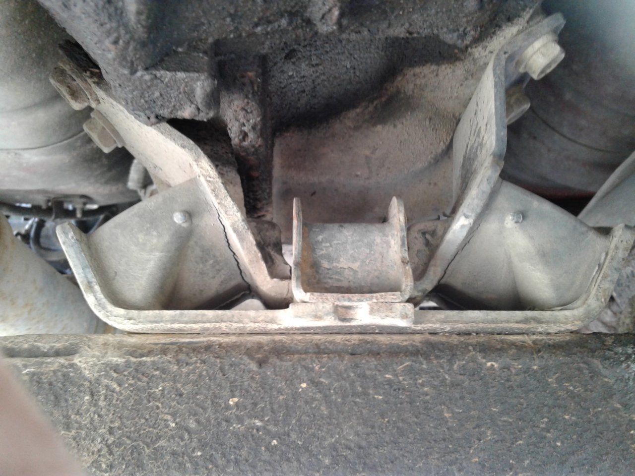

    What are you all doing for transmission rubber mounts? Mine is shot and I am not able to find one - aftermarket or OEM.
    Seems like they are all for the 3.4.

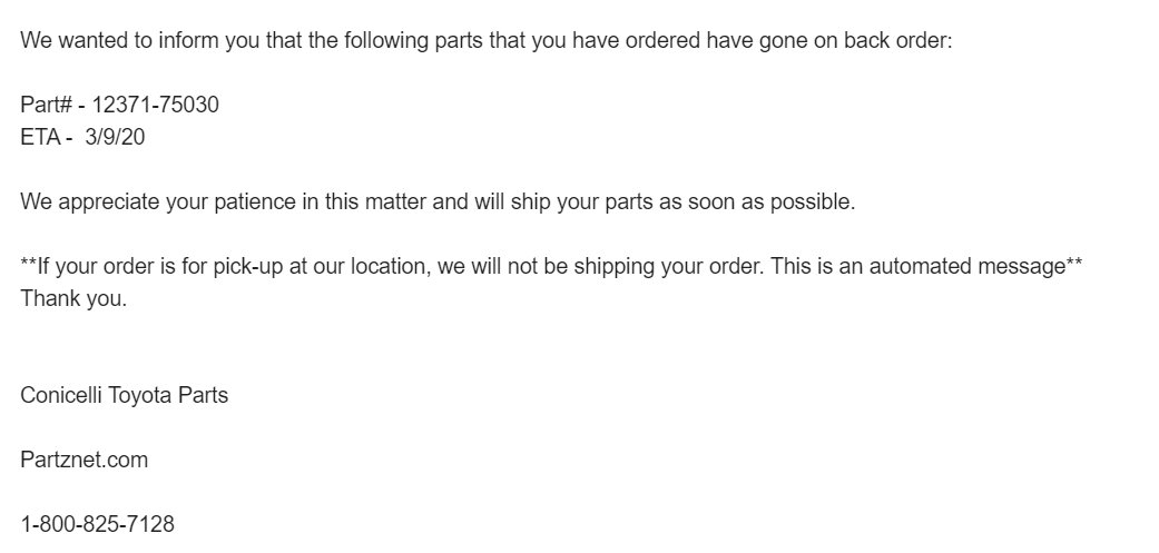

    I tried ordering this one from Conicelli a while back and it was not available.
    I found another number that I think may work. I will post up if available!

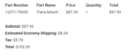

    I ordered one listed for a '96 4 cylinder 4runner. I found the part number HERE. Sure looks like the right one!
    It was 12371-75030. $102 after tax and shipping from Conicelli. Should know by tomorrow if still available.

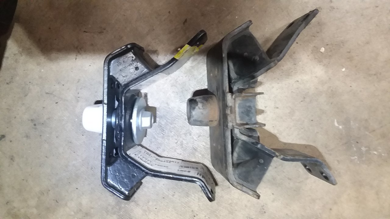

    To finalize this thread....
    My truck is a 96 4x4 4 cylinder manual standard cab.
    Here is what I ordered and it worked great:
    Here they are side by side:

    The confusion is probably related to the change of the retainer. On the old one it looks like some sort of bracket, the new one is a bolt and washer.

    If a part you order from Conicelli is not in the local warehouse you get the back order email
    The message you don`t want is the discontinued message
