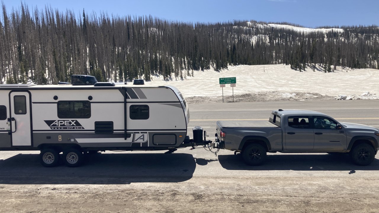

    Photo of the rig at nearly 11,000 ft elevation on Wolf Creek Pass, CO.
