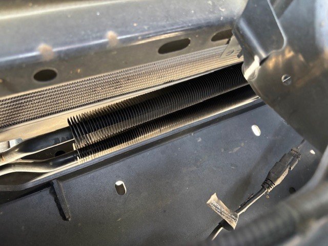

    Mine has the towing package and has a transmission oil cooler also.

    You are misinformed. Open your hood and take a picture looking down in front of the radiator. There would be a small (~5"x9") cooler just below the horns on the driver side, but it's missing on your truck.

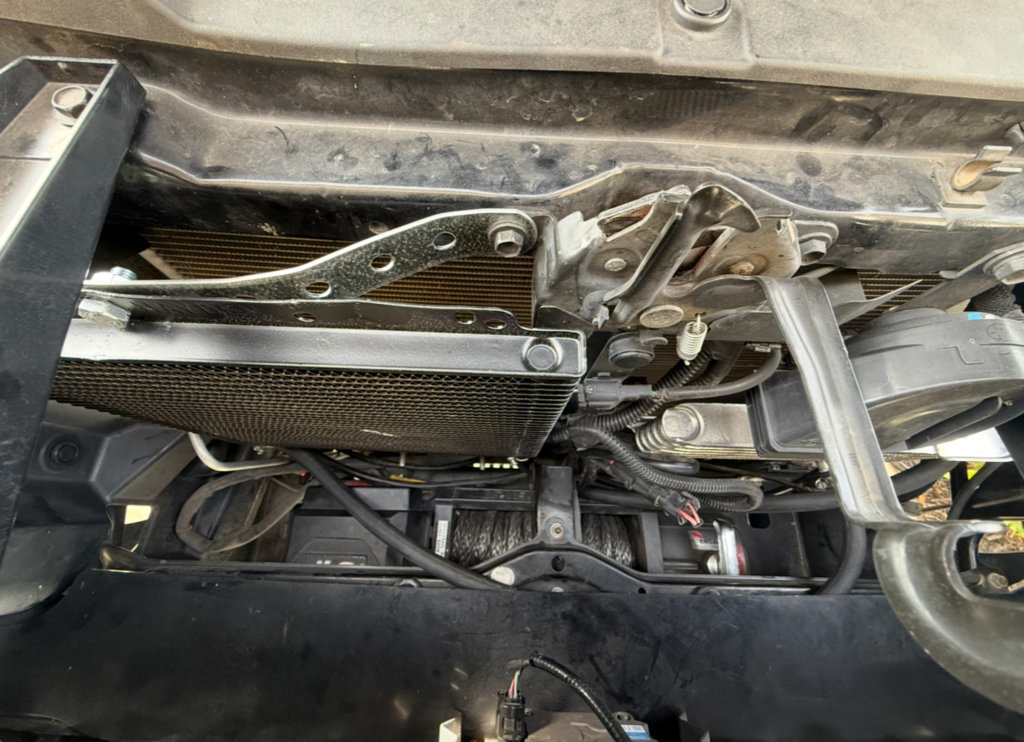

    Here's a picture of mine with the OEM cooler and a Hayden 679 run inline on the passenger side. If you're seeing a very small cooler in there that's for the power steering.

    It's about 5x 18 inches

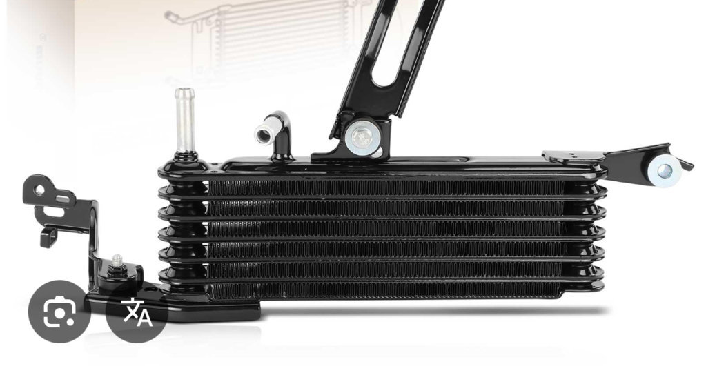

    That's your power steering cooler. OEM oil cooler looks like this:
    Just trying to help you out man. Do with this information what you will.

    Why on Earth would adding an electric fan void the warranty? My truck is heavily modified and just got my timing cover gasket leak repaired under warranty @55k.
    Speaking personally I have watched my temps on a scanguage for years and they've always been high when highway driving, towing, or offroading.
    First I pinned the thermostat and got very little change, then added an OEM cooler with similarly little change, then added the Hayden 679 which finally made the difference.
    Now I'm cruising on the highway in 95f temps with trans pan temps @185 instead of 220+, and running 165-175 around town.
