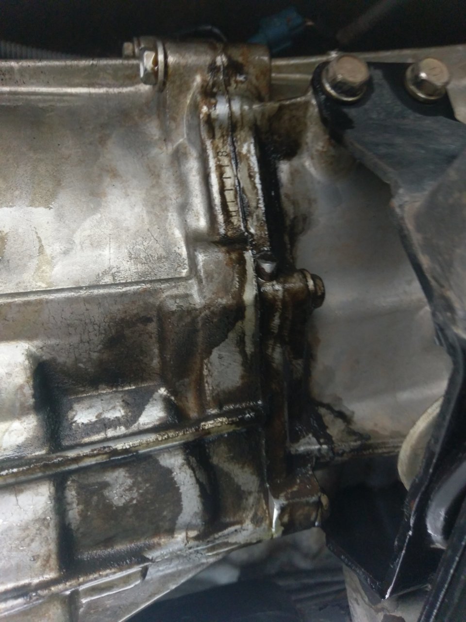

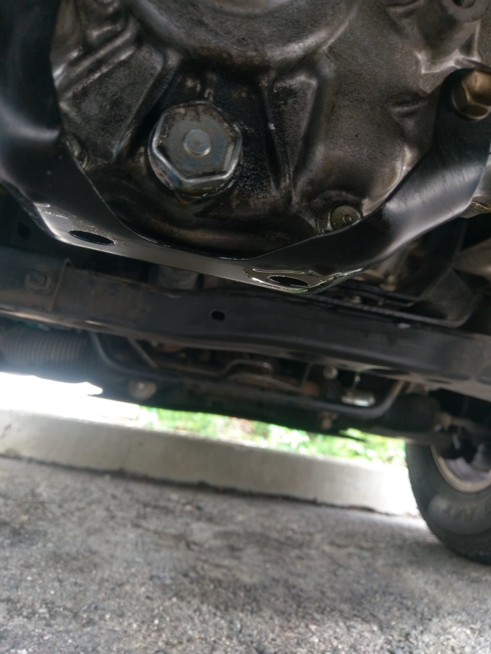

    Ok so it seemed like the leak was gone but after driving around a bit today it is definitely still there, here are some pics. The only place it actually drips onto the ground from is the transfer case drip pan but it also gets all over the transmission im not sure if this is from splatter or if the leak is somewhere near the top of the tranny. It seems to get pretty dirty at one of the seals(in the pic). Any advice?
