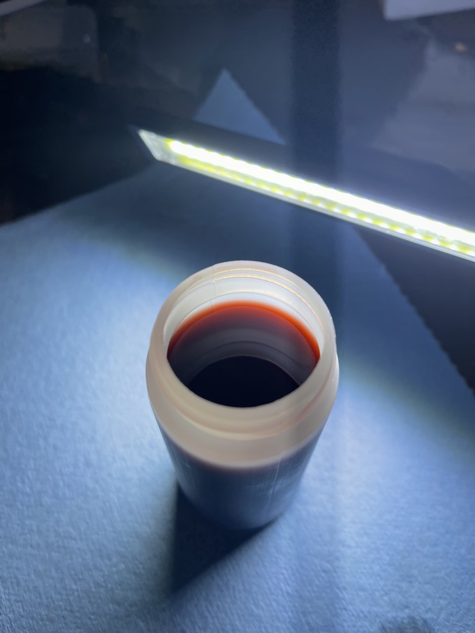

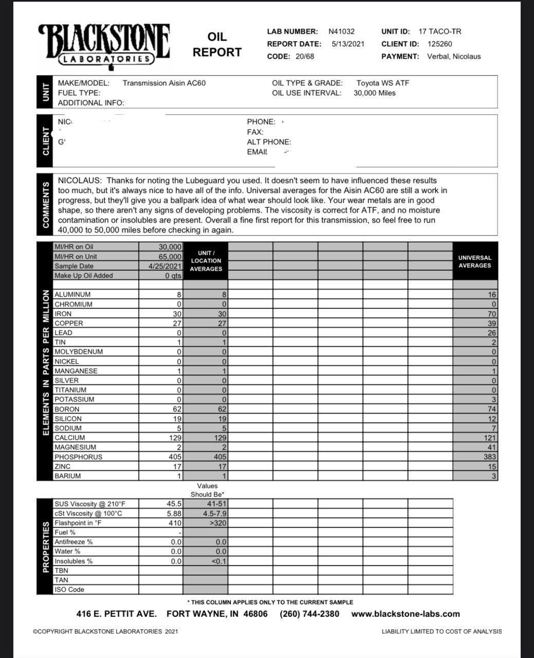

    Here’s a report from black stone. I don’t think they have a lot of data points available, so take it for what it's worth. This was the 4th drain n fill in 65k miles.

    4x in 65k miles??? Seems extremely excessive. So, I have to ask why?

    That is a lot of drain and fills with that few of miles. Were you having transmission issues or something?

    Because a spill n fill is about a third of system capacity and I've been known to eat up transmissions, I've replaced 7 transmissions in the last 2 vehicles I've owned.
    Also, I'm not necessarily sold on the life of the oil.

    Nice to see this info...Thanks! I did a 6 quart spill n fill as you call it (3 qt then drove a few mile then the other 3) at 30,000 miles. I figure 3 qt (spill n fill...love it!) every 20,000-30,000 is cheap insurance plus refreshes the oil. Arizona heat is a killer in the summer and hard on vehicles especially in stop and go traffic. I spent 7 years there, lived in Mesa, worked at Williams AFB when it was open.

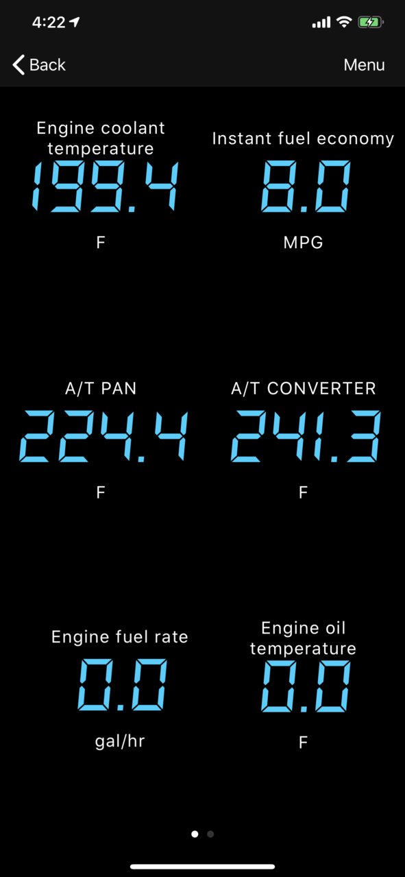

    Shit man I've had pan temps way higher than that lol

    Something is wrong with your AT cooling setup. Generally temps of the coolant and AT Pan should be close (+-10°)

    That was completely stock (thermostat,cooler), after pulling a hill in the dead of summer
