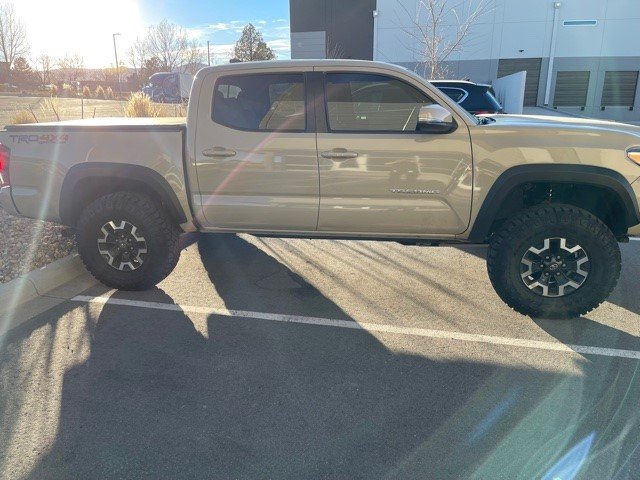

    Hey TW, I've been experiencing issues with my 2017 Taco Off-Road. The issue I've been experiencing is the truck jerking when I'm turning from a light making a wide turn. It only happens the first drive of the day (usually when I'm going to work) and the truck only does it once a day. I do have have 33'' tires, a lift kit was added and 70k miles on it but the truck was doing this before those modifications were completed. There's probably a thread for this but I couldn't find one.
