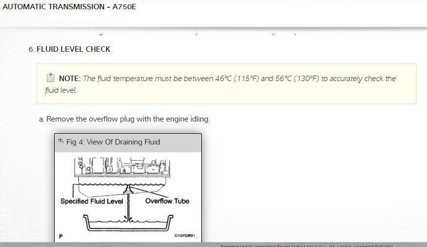

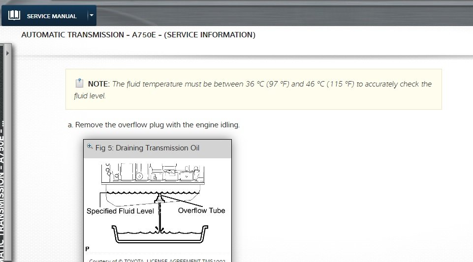

    Interesting, it seems they changed it somewhere between 08 and 2010 not sure why.
    From 08 service info
    From 2010 service info

    I always just jumper the pins on the OBD connector and use the AT TEMP light on the dash.

    The tacoma is one of the first sealed units, but I have always seen 35-45 on every model, even now, I wonder if any pre-2010 other models share differing temps. I'll check im bored.
    optifree likes this.
  18. Aug 11, 2022 at 8:01 PM
    #18
    Bishop84
    Bishop84 Well-Known Member
    Dec 17, 2015
    #172494
    11,765
    They amended it, I cannot share the tech tip, but it shows they intended check temps to be lower.
    The tip was released in 2008 if someone can find one that is public.
    optifree and Dm93 like this.

    Found it, TSB #0129-08.
    Thanks for the heads up, everyone has been going off the procedure in the 06 FSM since it's the one that's most common to find in the wild. I never noticed that it was different on newer model years.
