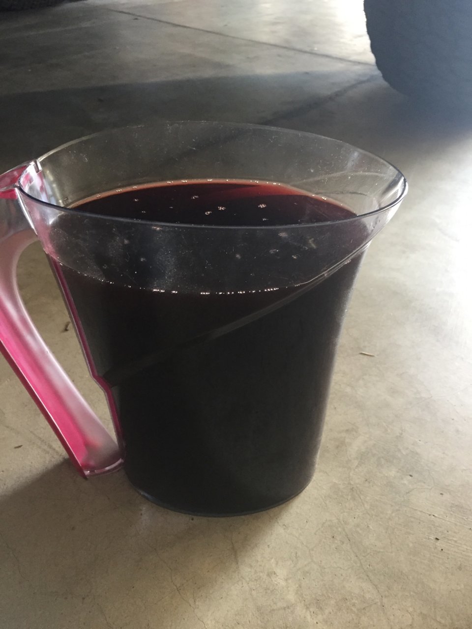

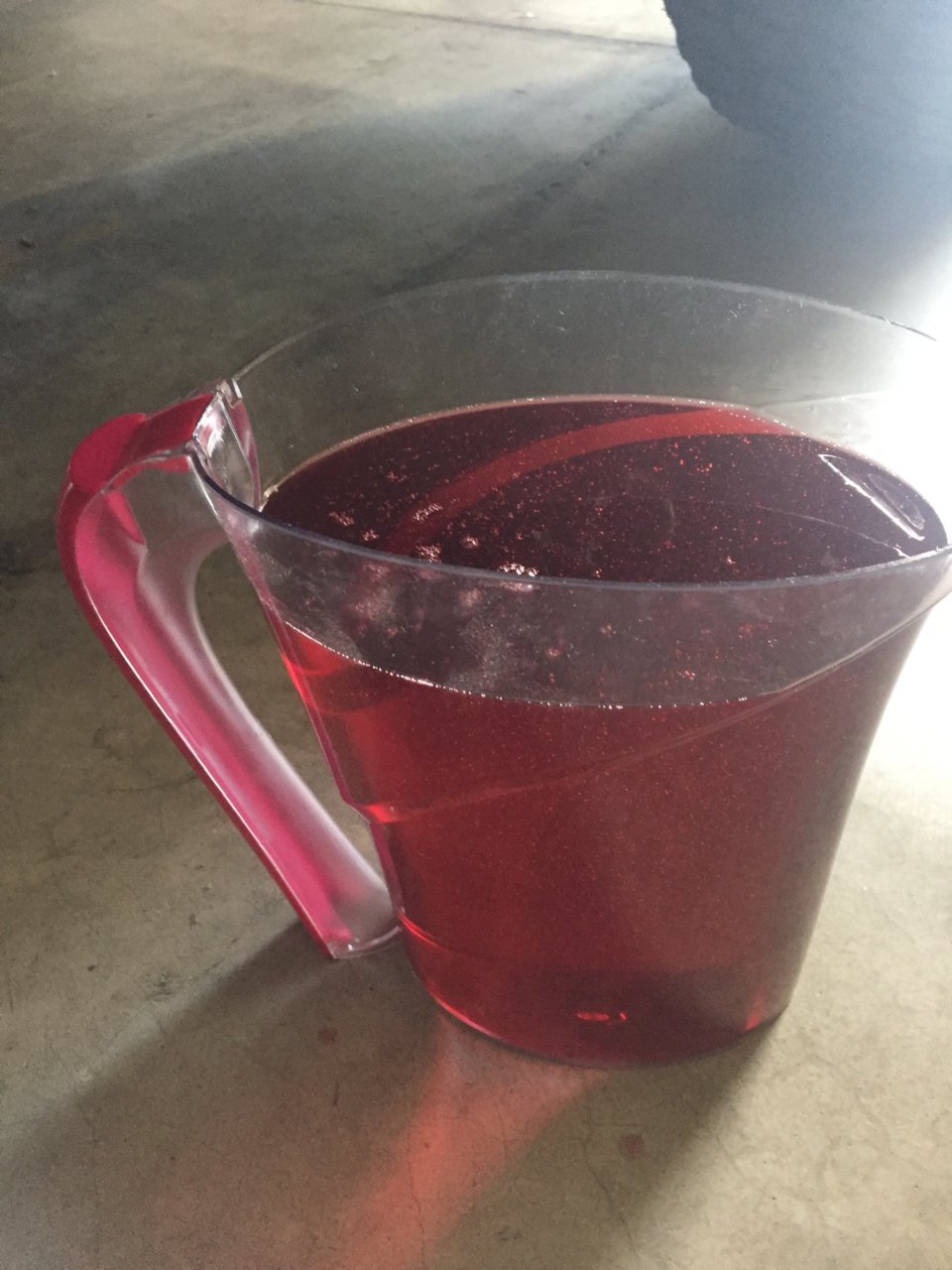

    I just did several drain and fills.
    Pulling into the garage from the driveway cold and then draining produced 2.25 quarts.
    Driving around for a few miles and then draining produced 2.75 quarts each time.
    It still looked pretty good.
    Old:
    This is 2.75 quarts.
    54D970E0-15CA-47B6-A8D2-E5E2B092B9FE.jpg New: 01915058-9702-4555-8ED3-26F595DD7FB6.jpg
