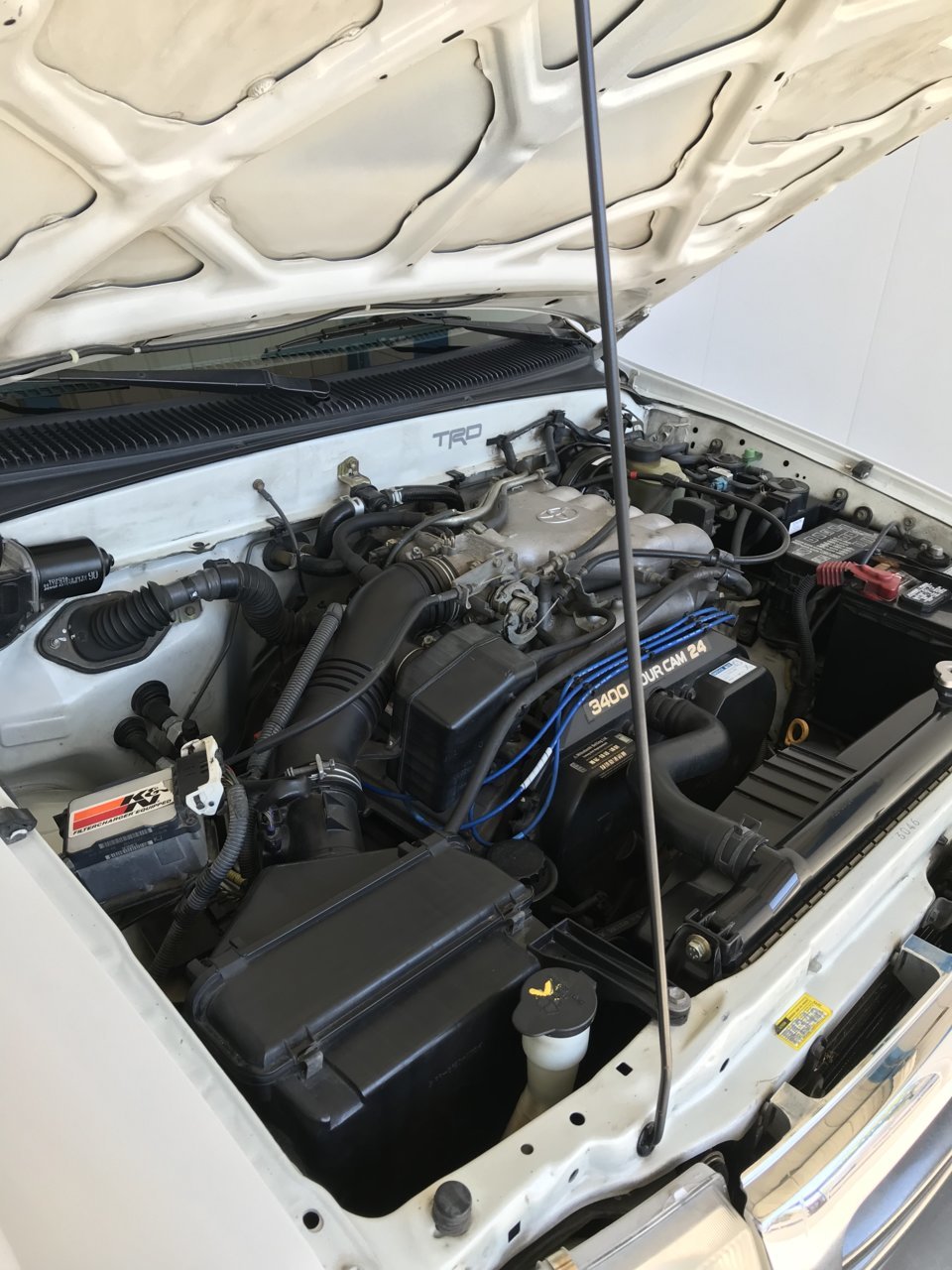

    I a few months back had the valve covers done due to a leak dripping down to the bottom of the transmission housing. Thought it was a rear main seal but did those first. Dealer replaced gaskets and I made sure they re sealed all the half moons, spark plug gaskets and replaced the cam plugs and intake manifold gaskets. They even cleaned up the valve covers that had grease on them and no oil leak at all now. The oil below is a red ish brown, since I’m still trying to cycle new fluid in every time I do the oil to get it better without shocking it with a full flush since I’ve been doing some catch up maitnence from the previous owner.
    100% certain leak is strait from tranny pan.
    I’ve got the motor looking pretty mint as far as grease or any oil anywhere.
    My tranny shifts like butter, no jerking or slipping. I’m trying/praying to get it to reach 300k so I’m really wanting this stupid leak to be done with as I have a almost $2k service coming up for a COMPLETE timing belt change with everything that should be done along with changing all 9 coolant hoses. This will be done at the dealer though from now on.

    Wow now that’s a nice engine bay. Yea I did the vc gaskets, cam plugs, half moons spark plug tube gaskets and cleaned everything. Did intake gaskets too. I have the two o rings to do the oil cooler too, it has a slight seepage. Did you say you were getting a new pan? It has to be something outta wack for it to leak like that.

    Thanks, put a lot of work into it cleaning it up and fixing little ends here and there.
