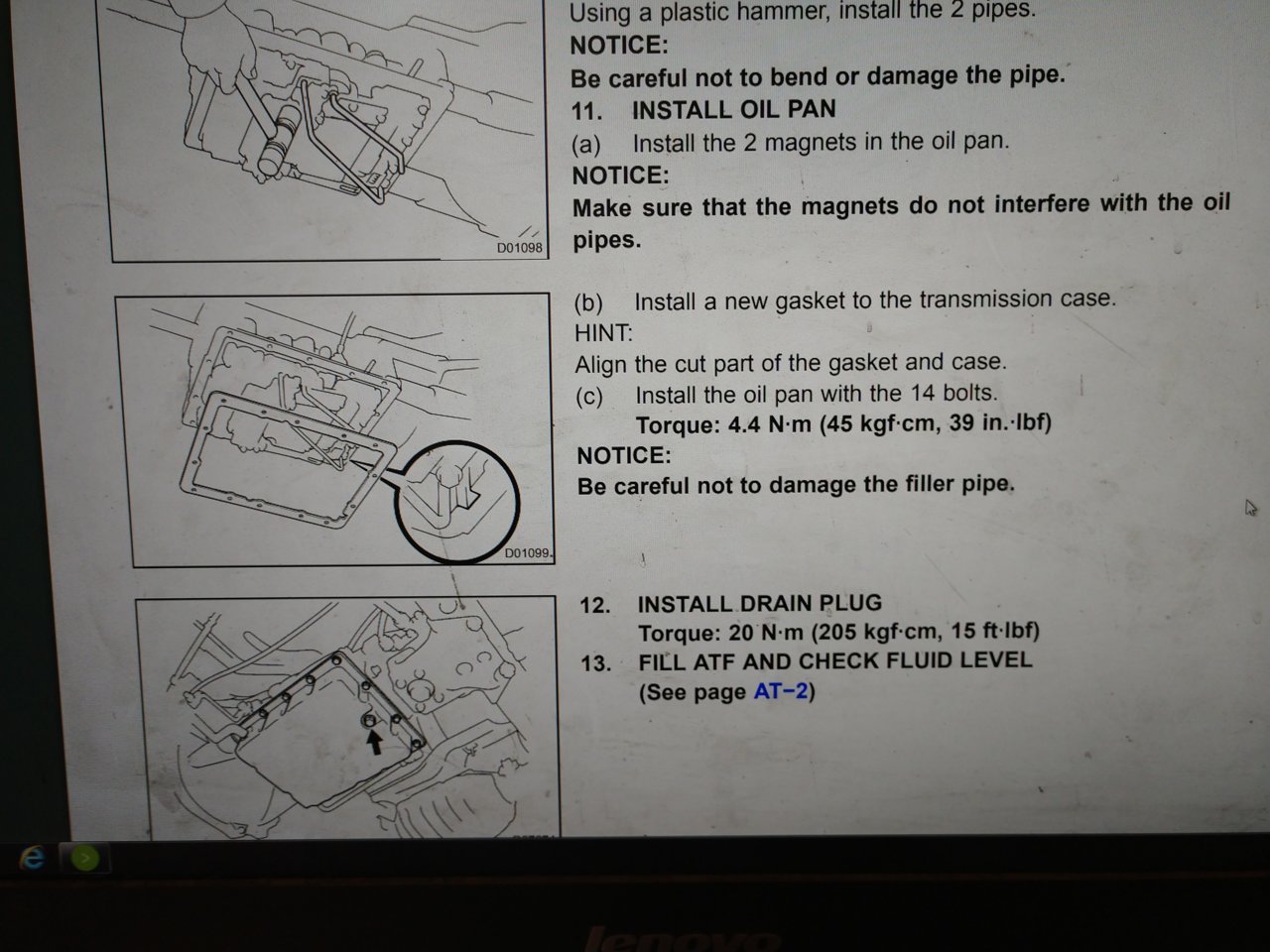

    I saw the pic with the Toyota Fip box, the box in your hand says camshaft housing. The Fip inside the tube is black. The black fip WILL not seal tranny fluid. Depending on which route you take with the pan, make sure whoever replaces or attpts another reseal to use the ORANGE Toyota Fip. It is specifically designed for the trans pan, and also other drivetrain uses.

    Ok. Did a little more research. Your transmission does use a gasket (4wds use fip) the torque for the bolts is very low, 39 in.lbs, which is also 3.25 ft.lbs. If the bolts for the pan were over-torqued, the gasket itself can split, causing your leak. Also, another thing to consider is a leak from above, say the extension housing, that is misleading you.

    I haven’t Hurd anyone say prerunner actually uses a gasket? Is that straight from a 99 service manual?
    And I am pretty darn sure it’s from the pan as everything is really wiped down even on top, and it’s not wet in top, just at rear seems you can see the fluid in the crack

    2001 Tacoma 5spd
    Yep, straight from 99 repair manual

    Well, I have no idea what is right, apparently service manual though if that’s really it I would imagine dealer would do that but they didn’t recommend a regular gasket. I really don’t know

    That is definitely straight out of the repair manual. But in theory you shouldn't have had to pay each time, "ever since" are the 2 magic words in dealing with shops. "Ever since you guys did my trans pan, it is still leaking"..

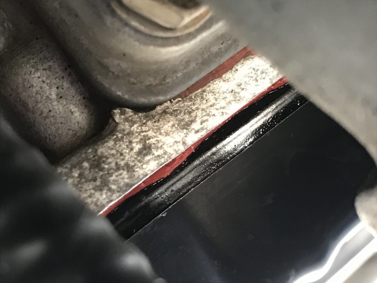

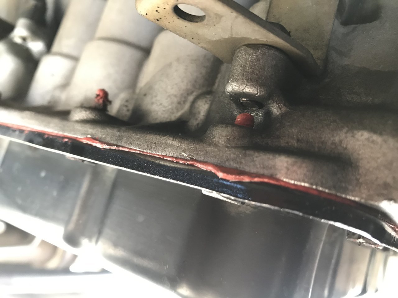

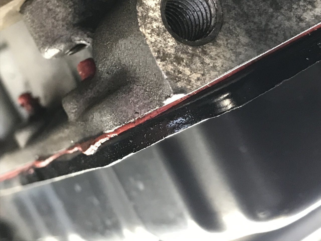

  20. Jan 11, 2019 at 10:06 AM
    #60
    Tac_99
    Tac_99 [OP] Well-Known Member
    Oct 4, 2017
    #231987
    91
    Anthony
    99 Toyota Tacoma TRD
    These are pics underneath about 1k from dealer. First got it back everything was bone dry. Now if you look close you can clearly see the wet looking oil on the gasket inbetween pan and transmission and the pan edges are wet looking again from the seem sealing
