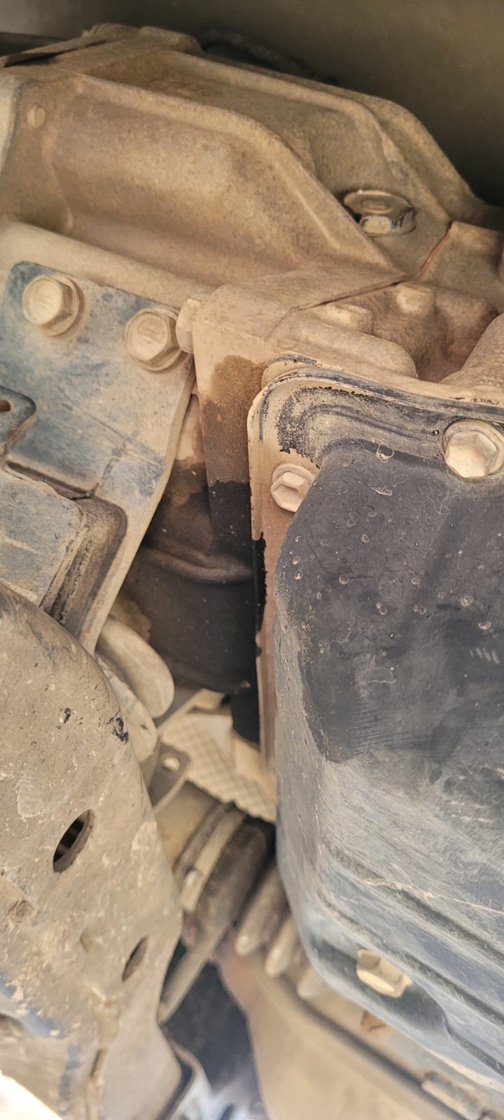

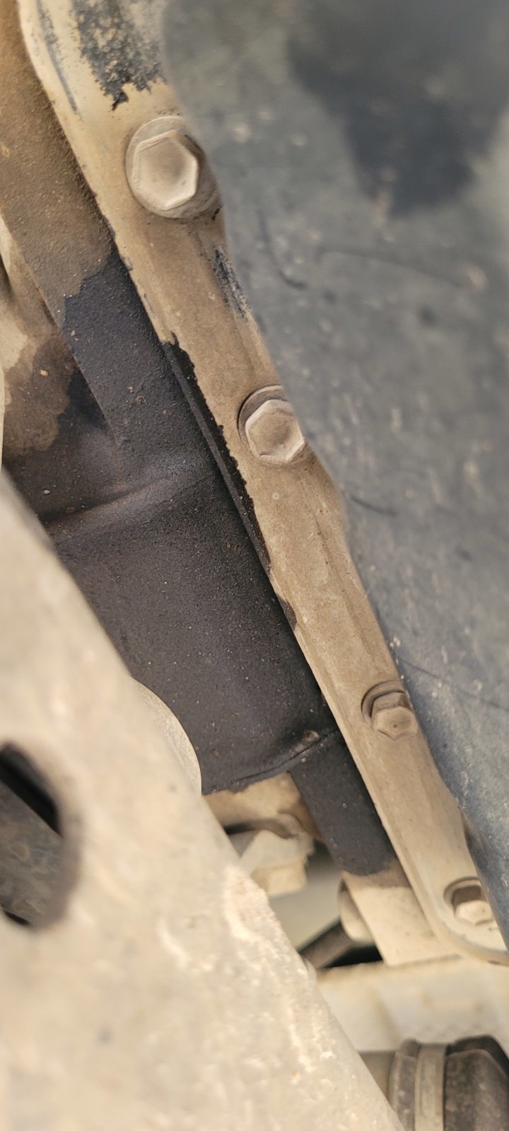

    Hi everyone, I was going to do a drain and fill on my transmission (auto V6 Tacoma 4.0L 4x4), and I noticed it is wet right next to the pan. See attached pics. Does this look like a leak to you?

    Looks more like a transfer case weep.
    I would keep an eye on it, but it’s nothing I would concerned about……no puddle, no leak.

    That looks like the leak is originating from further up. Like @faawrenchbndr said.
    Doesn't look like a pan leak to me.
