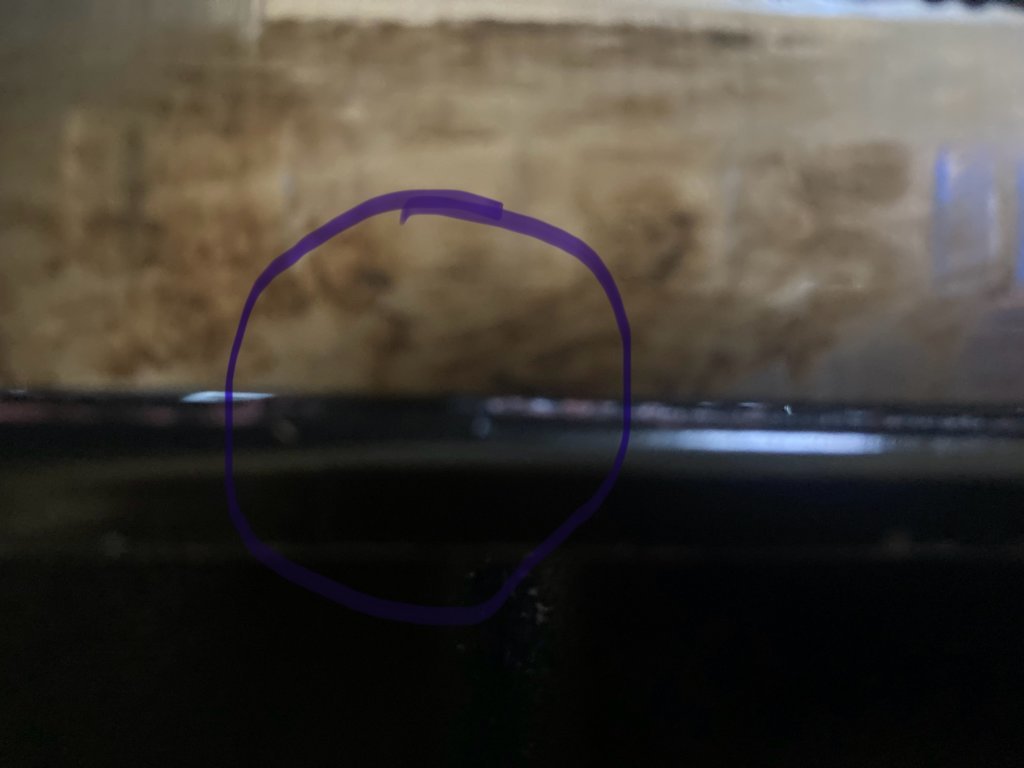

    so this is a bolt hole on top of the flange. You can see the gaps around it. So using your method, would it be better to put something flat on top of the pan & go at it that way? Or does that somehow compromise the pan?

    I thought the FSM said to use RTV / FIPG?
    A gasket is easier to use, but RTV seals it up in all the nooks and crannies.
    Maybe use the gasket and a dap of RTV at the bolt holes?

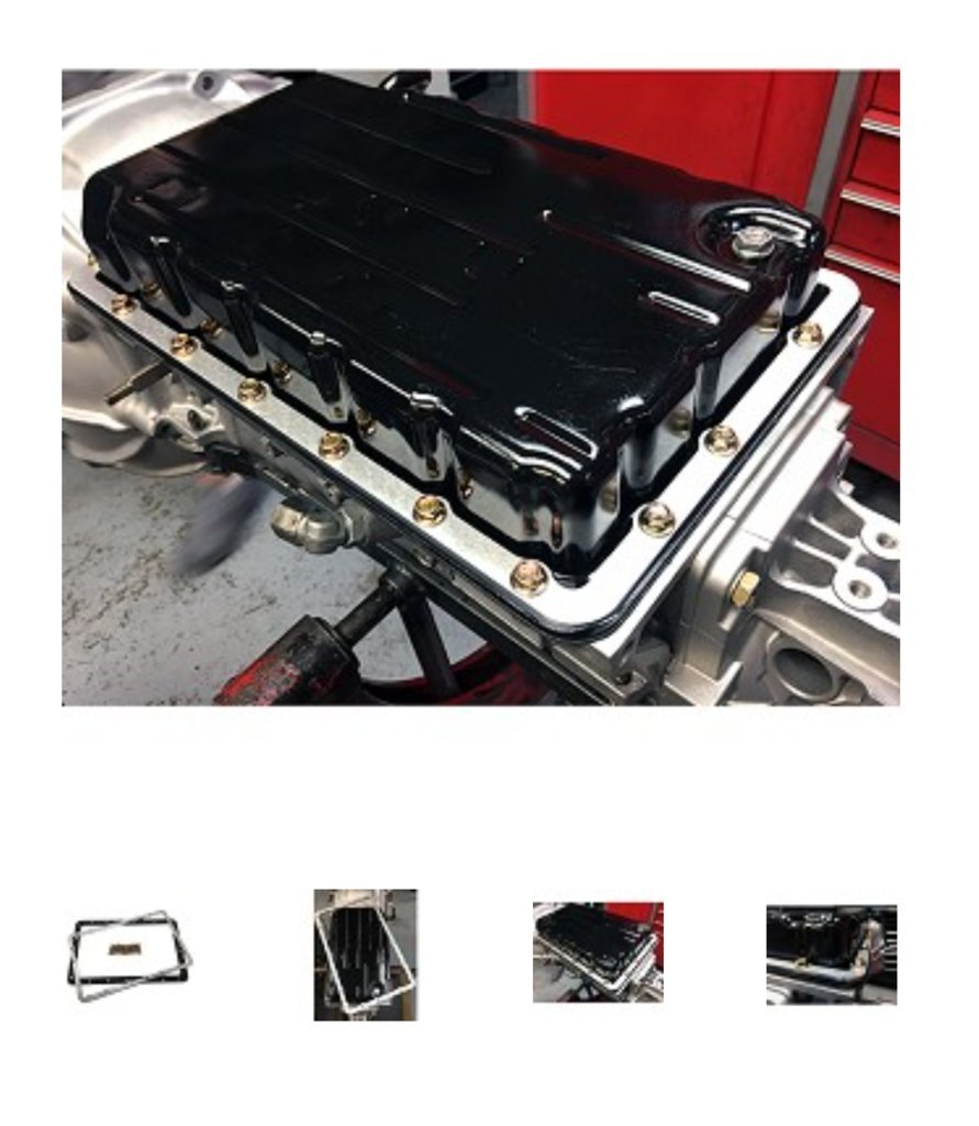

  10. Dec 2, 2024 at 1:46 PM

    I’d say try to flatten it, run a straight edge and make a choice on whether it’s an acceptable tolerance or not. You can also circle the bolt holes with goop

    My 2 cents - since the pan is already "compromised" don't waste your time trying to tweak it back into service. I'm looking at the time involved with trying to flatten it out, reassembling, etc. Just order a new pan, FIPG it and call it done. You won't have to worry about dropping the pan for years to come.
    Just how I see it. Time is valuable and I'd rather do it right the first time. :thumbsup:
  12. Dec 3, 2024 at 6:36 AM
    ToyRyd04
    ToyRyd04 Taco Transformer
    Aug 5, 2011
    #61217
    1,891
    Greg
    Perryville, MD
    '04 PreRunner
    SAS'd PreRunner Diamond Axles Crawlbox

    Late to the party here,,,, but I've lived through all these changes since the 50's and 60's till now,,, all the pans and valve covers "dempled" in and cut the gaskets. So the trick was or what I used was to lay a 2x6 or bigger on edge, take the valve cover or pan and set on the edge of the board flange UP, this is for support and straight edge effect, take a ball pein hammer and lightly massage the demples back down with the ball end of the hammer, I even took them a smidge below so that it had some leway to function and not cut the gasket, if that's what you decide to use, or RTV or a combo of both.

    I’m late too, but Permatex 90 minute or 1 minute The Right Stuff, which I’m pretty sure is a more readily available version of the Toyota FIPG, would’ve made easy work of that.
    We’ve sealed up holes/cracks in oil pans on our race cars with it since those double kicker SBC pans aren’t cheap. Use it and the one minute version for pretty much everything on the race car that doesn’t have a solid reusable gasket. From oil pans, hub seals, cracks, water necks, water pumps, etc. It’s even solely what’s holding my homemade cold air box to my breather base on my dirt track car. The stuff is easy to remove with a scotch lock on a die grinder when you take the pan down the next time. That or a razor blade. I swear by it now.
    The strengtheners that ToyRyd04 mentioned are similar we use on the oil pans on our SBCs too.
    Pulldo has a great method for fixing your current one as well although I’m 99% positive the right stuff would’ve been your cheapest and easiest fix without having to do any work to the pan.
