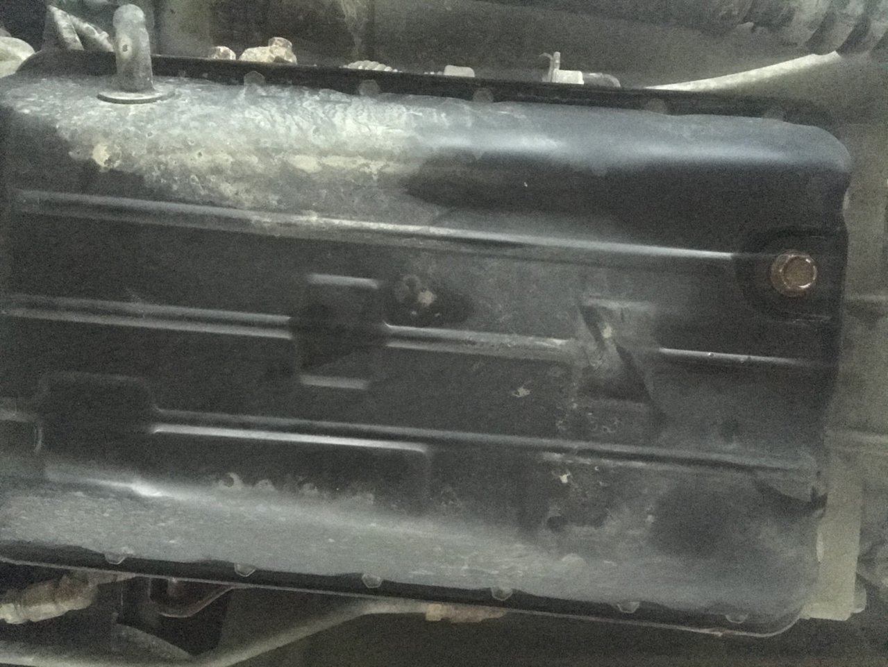

    6EDFEA98-E59D-4746-810A-251A18EA510C.jpg Here’s a photo of the pan, for reference. I didn’t see a transmission dipstick anywhere, I thought that might be the case but I didn’t see one.

    The A340 has a dipstick. It should be under the hood and have a red handle, the engine oil dipstick has a yellow handle/pull loop.

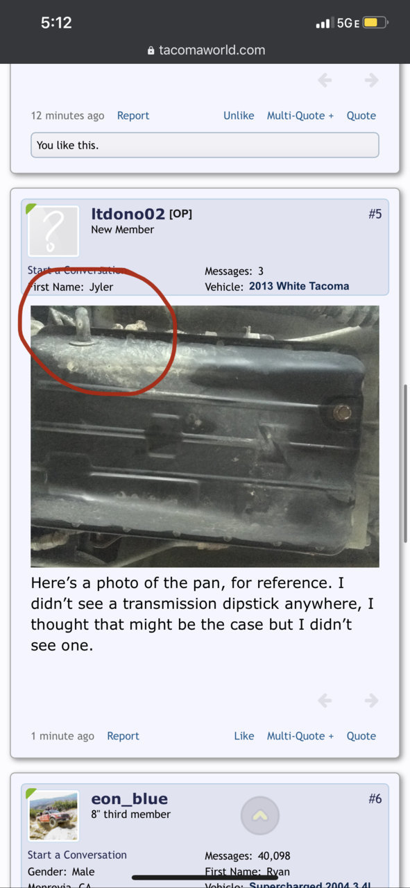

    Dipstick circled in red.

    Yup, found it tucked away in there. I saw so many of these videos with the three bolts that I thought there was no way my truck had a dipstick. Great! Thanks y’all!
