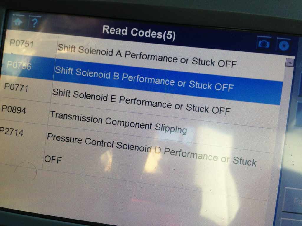

    Reverse in the Aisn Warner A750 is mechanical ,not electrical or ECM solenoid controlled . If you are not getting reverse I would be looking at the control valve body .
    If you are getting good reverse but your upshifts are messed up , find out why those codes are coming up .
    The newer transmission will do the same thing because the ECM sees an issue with the wiring going to the transmission and commands your transmission into fail safe
    The computer is designed to prevent any further damage to the transmission .
    A private subscription to all data may be what you are looking for to diagnose the problem .
    All Data is about the only company that can give you a Toyota electrical breakdown for the transmission control circuits coming from the ECM .
    https://checkout.alldatadiy.com/ade...ke=121914475&model=121914587&engine=121914593
    If I had to guess , you have an issue with the wiring from the ECU to the transmission .

    Truck is popping up a ton of different codes now du5yhe7e_9a487c20232797256bf8df25c8f2a737830eaff4.jpg

    I used my dvom all my resistance is good went over all my grounds cleaned them reconnected them. Now I'm popping up these new codes. I'm so lost
