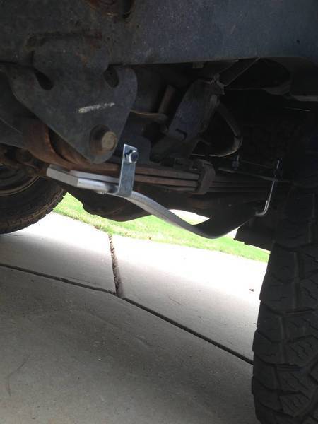

    it turned out to be axle wrap. my tranny shifts smoothly through all the gears. so i went and bought helper springs for $37 and it fix it. they just bolt right on
