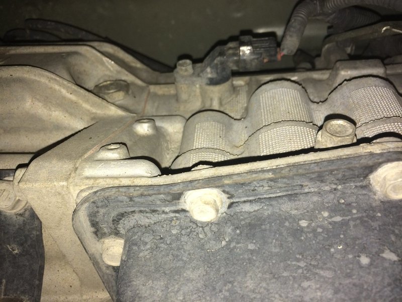

    Can someone confirm that the plug in upper left area of the photo is the fill for the tranny? I've seen videos on different models but I'm not entirely sure where it is on my truck, and need to be sure I can fill it before I drain it.

    Yes, that's it. It will have "WS" stamped on it, although you probably can't see it until you remove it. You will need a 24mm socket, I recommend a 6 point socket over a 12 point. The head isn't very prominent and easy to round off with a 12 point.
