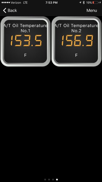

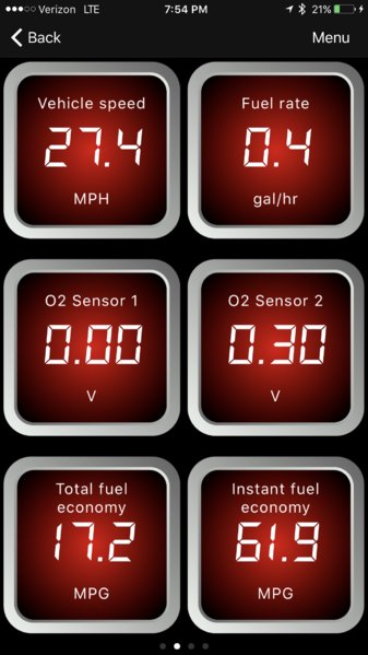

  8. Apr 9, 2017 at 6:27 AM
    Gravybird
    Gravybird [OP] Active Member
    Jan 24, 2017
    #208480
    30
    Central MN
    17 Black TRD Sport DCSB
    Predator tube steps, mud guards, Tonneau cover, TRD exhaust
    I bought the OBD fusion app (iPhone) it's $9.99 and then the upgrade for Toyota, another $9.99 and I'm able to watch the transmission temp plus a million other things that are beyond my needs and wants. Thanks for the heads up. Way cheaper than a scan Guage.

    did you need to purchase/install anything else for this app to work? I have a 2016 Tacoma, will this work just with the bluetooth feature on the radio?

    You will need a Bluetooth OBD adapter. I have the carista unit but there's plenty to choose from. If you go to this apps website it has a list of compatible adapters. I think some are as low as 9 bucks. It will into the OBD plug which is under the trim by your left knee.
