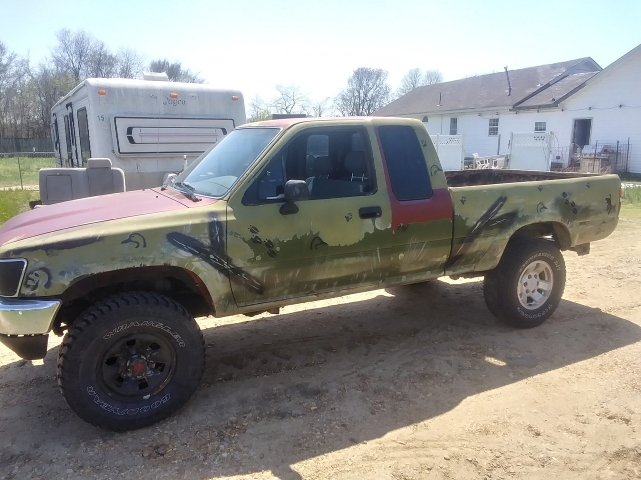

    This is my little project I got about 3 months ago. Motor was blown up. It had been sitting for 10 years. So I had to replace the tank and that stuff. But I only spent about 300 bucks to rebuild the motor and other than the horrible paint job some butthead put on it , she is straight and rust free and runs great. Inside is good except for the headliner. Other than that , I got a good little run around truck. For 500 bucks and about another 400 in her, I'm tickled . And you can bet ur ass she's a five speed.
