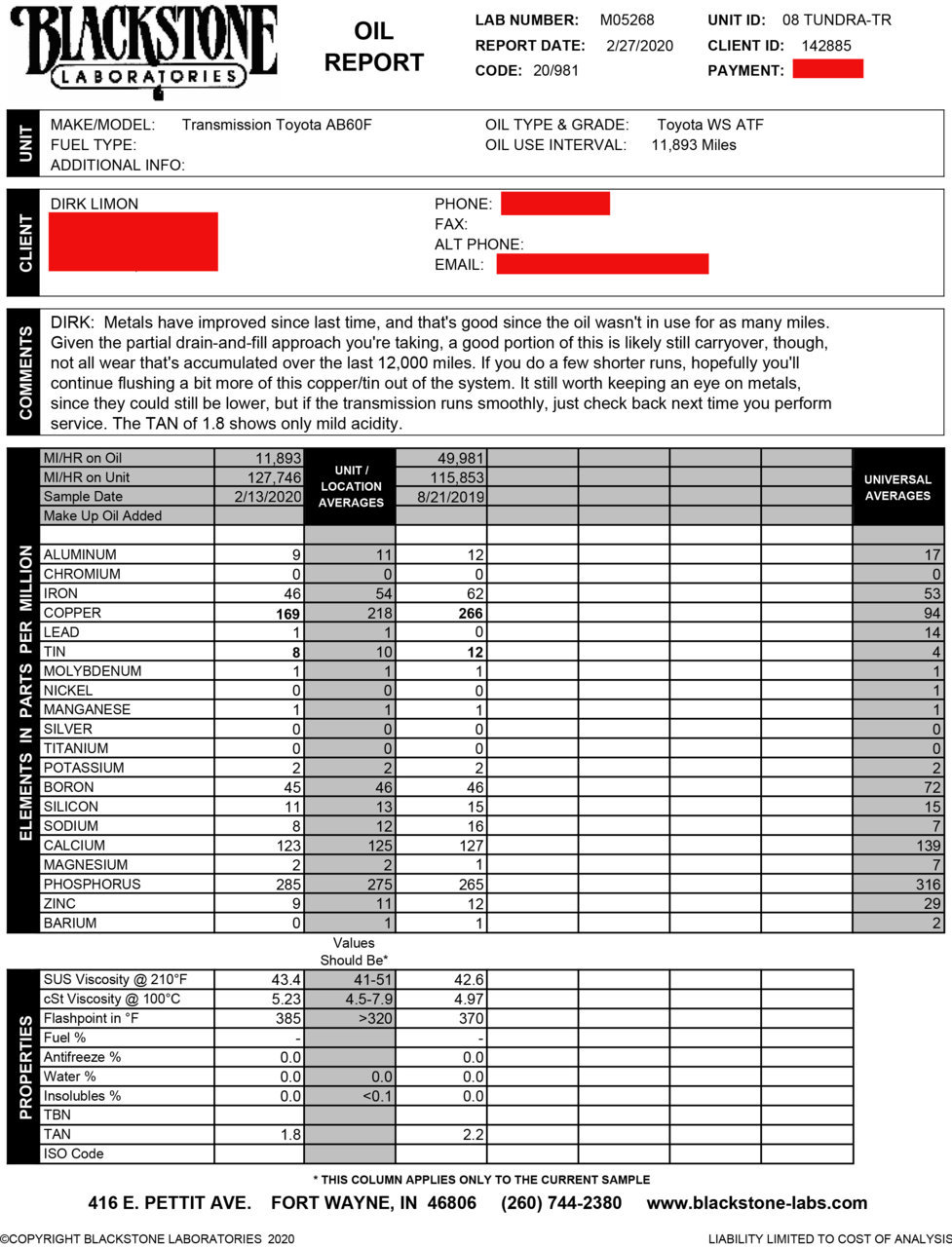

    Did you find any metal pieces or shavings in the fluid?

    Just a little at the bottom of the pan. The magnets had quite a bit but that was to be expected especially for the first time. My philosophy is if you change it regularly you shouldn't ever have to flush it as you keep the fluid turned over. All you want to do is just replenish the additives that deplete a little overtime you never want to allow it to completely go bad and then try to put a bunch of good fluid in it to me that's where you screw up.

    Thanks for sharing your findings. Those pan magnets have a decent bit of build up. Good to know the pan gasket is reusable.
    I have a similar philosophy. For transmissions, drain and fill cycles for 80% fluid replacement every 50k miles. It's quick and easy given the plugs, albeit new fluid is wasted in the cycles. I don't bother removing the pan for filter or magnets. To me it's better and lower cost to keep the fluid consistent and fresher by drain and fills rather than do a flush and run the fluid to burned out.

    We do have some solid data from the 2nd gen 5 speed transmission .. Aisn Seiki A750E series transmission .
    What we have learned is that the valve body on these transmissions are designed out of a solid brick of aluminum to save weight and are extremely susceptible to wear when the re-agents in the transmission fluid begin depleting .
    Because our transmissions are completely computer controlled , the computer compensates for this wear factor and the operator of the truck believes everything is fine because the truck still shifts fine .
    The 6 speed Aisn Seiki AC60 series transmission found in the 3rd gen is very very similar to the transmission in the 2nd gen trucks .
    The 6 speed now has 5 or 6 years of operation if you include the vehicles that use the 6 speed overseas .
    We are beginning to see very similar findings to what we found with the 2nd gen trucks and many of the same complaints .
    Where am I going with this ?
    Change your transmission fluid .....Keep it clean
