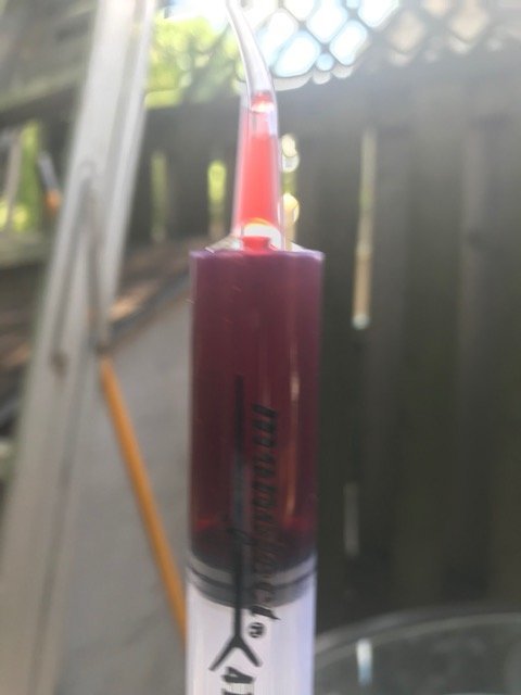

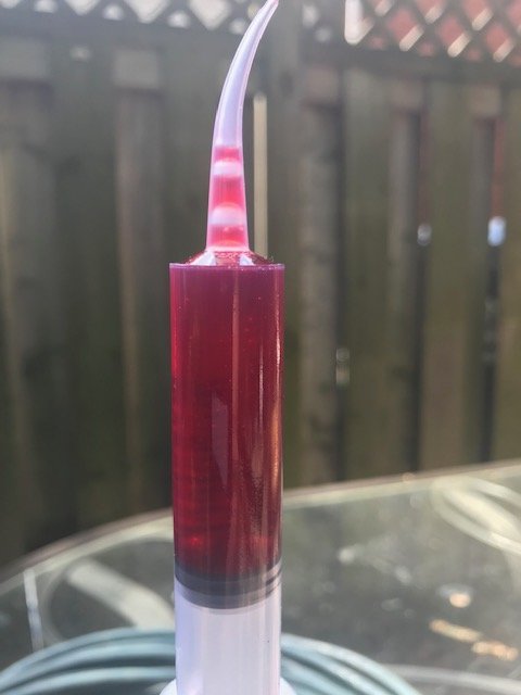

  19. Oct 18, 2023 at 8:22 PM
    #99
    babylon5
    babylon5 Well-Known Member
    Aug 19, 2015
    #162175
    917
    David
    2015 Tacoma Double Cab TRD Sport
    That's exceptional and surprising if there was almost nothing on the magnet (do you have one or more than one (4) like the on the 750F transmission pan?? I have done 2 drain and fills in the 60,000 miles I currently have on my 2015. On the last drain and fill I compared the old fluid to brand new fluid. Was a little darker red but still clean and clear. Will be doing a pad drop and clean in the summer and curious whats on the magnets since i have been running a magnefine since very early on.
    New on left, old on right
