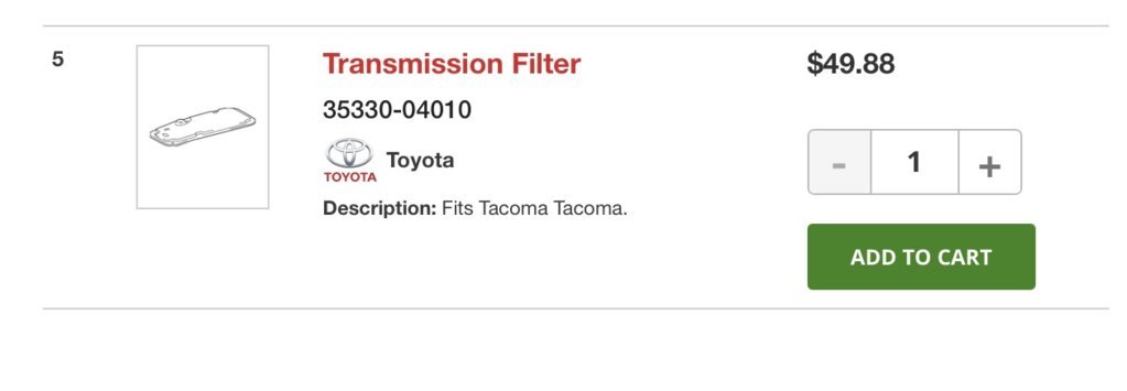

    Took our 2021 Tacoma, 3.5 l, to the dealership today to get an automatic transmission drain and filter replacement. I did not want a complete flush, just drain the pan, replace the filter and clean the pan magnets off. The engine has almost 50k on the odometer. The technician said that Toyotas do not have filters in the transmission, and they only do a complete flush. I did not want to argue, so I let it go as he checked the truck in. After he had checked the mileage, and VIN, I tried talking to him again. I said I am sure it has a filter, is it just Toyotas maintenance practice to just flush and they do not do the simple drain and replace filter, or is he saying there is no filter in my transmission. He again said, it does not have one, and no Toyota has one. He had been a master tech for over 30 years. So I did a quick google search for the Toyota part number for the filter, and it came up with the p/n and a picture. He stuck to his guns that my truck does not have a filter. What has been your experience with your dealership and getting the transmission serviced. We just bought the truck, so I did the front and rear axel, transfer case, plugs, PVC valve and the brake fluid. I just don't like doing transmission work in my garage. The auto parts store will not take used fluid, and it is always a mess no matter how hard I try to not spill any. I went ahead and had it flushed, we had to wait 3 weeks for an appointment, and I wanted to get it done before we go out of town in a couple weeks. Thanks Phil

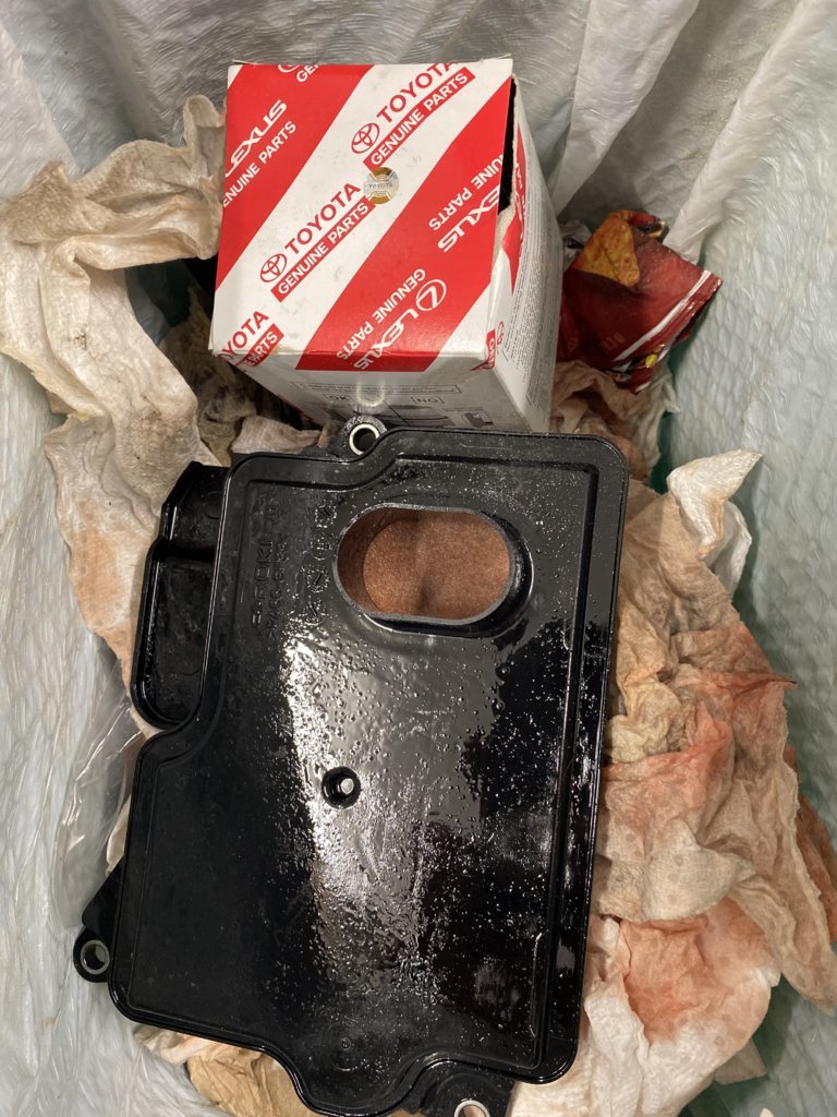

    The 3rd gen Tacoma does indeed have an actual filter.

    I found this: 35330-04010
    It was listed under ‘maintenance’ rather than ‘transmission’ parts.
    Some sites call it a filter and some call it a strainer.
    I haven’t worked on my transmission yet, so no idea if this is correct.

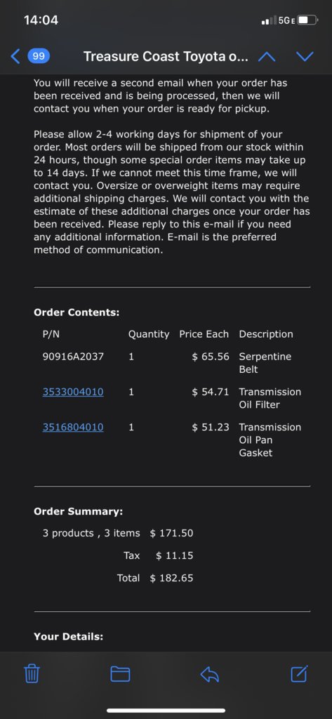

    I did mine around 80k. Think it was around 50 for the filter and another 60ish for a new pan gasket. I also cleaned off the magnets. Perhaps it’s not a filter like on the PDK in our macan but it’s still a filter. And why I don’t trust dealerships and did it myself.
