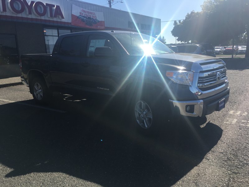

    I got tired of transmission and replaced it with this:

    But to be serious I also needed a bigger truck for afamily.
