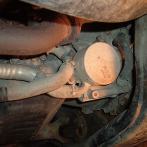

    The temperature has been hovering around freezing since, with no really cold days to see if it gets stiff. I'm going to get her back in the garage the weekend and locate that NS switch. I forgot to mention that she wouldn't start back a few weeks ago after a snow storm, not a gig, nothing. Boosted her thinking the battery was low... nothing. Just happened to jiggle the shifter, trying to get it into neutral and presto it starts. So all fingers are pointing at the NSS.
    Was hoping to see the switch hanging off the rh side and the instead it's the octopus below.

    ... and now with the pic!
  17. Mar 16, 2021 at 1:15 PM
    #17
    Skydvrr
    Skydvrr IG: @kalopsianick
    Sep 13, 2017
    #229889
    12,653
    Nick
    YMH
    Black '17 OR
    That's the trans warmer / thermostat right?

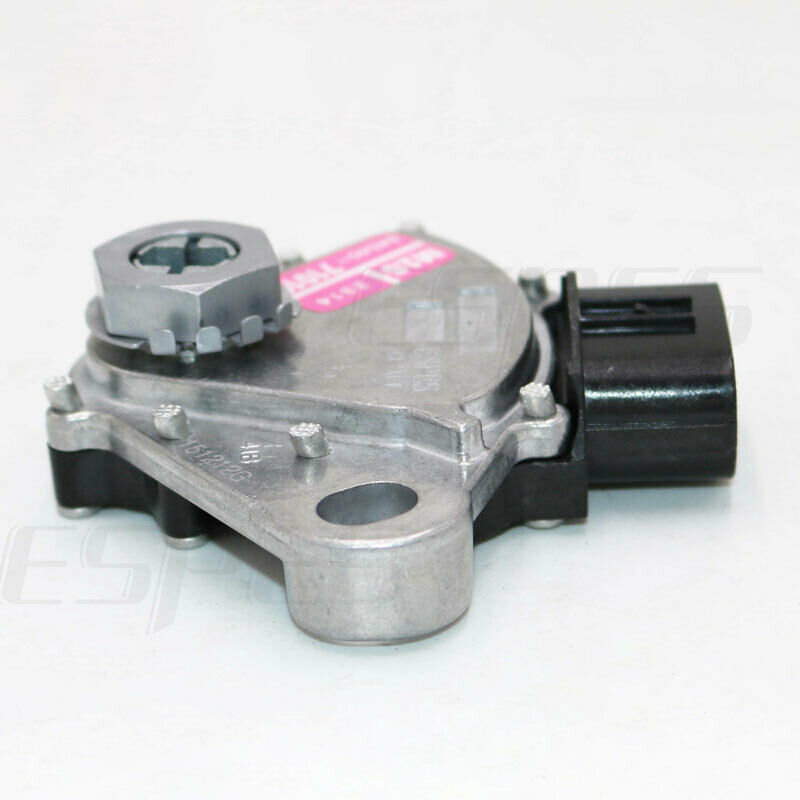

    It think it's up higher on the housing and more toward the back.
    Should look something like this
  19. Mar 16, 2021 at 1:57 PM
    #19
    roundrocktom
    roundrocktom Well-Known Member
    Feb 10, 2021
    #355715
    579
    2021 Silver DCLB Off Road
    That looks like the Park/Neutral Switch.
    Most likely is that cable binding
