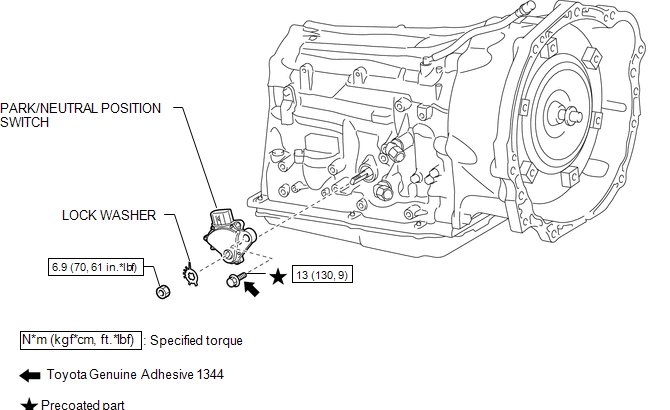

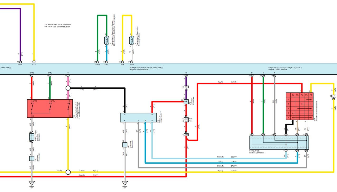

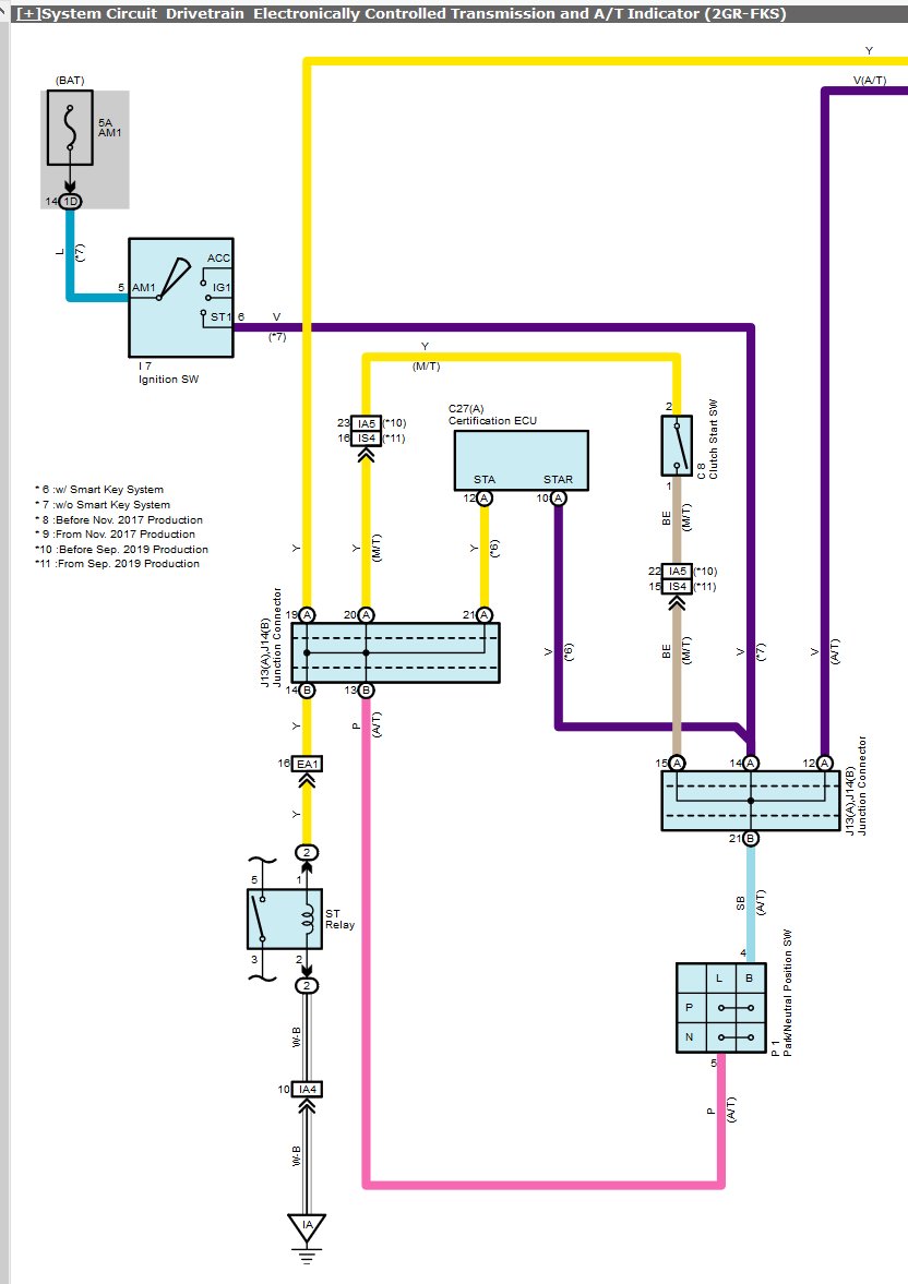

    Roundrocktom do you have the schematic for the neutral safety switch on the 3rd gen.?

    Wow, thanks, that's very much appreciated. Looks like the only thing the switch is NOT connected to, is the muffler!
    Just to confirm, the side view showing the location is for the 3rd gen. Taco?

    Correct. I'm looking at 2021 documents.

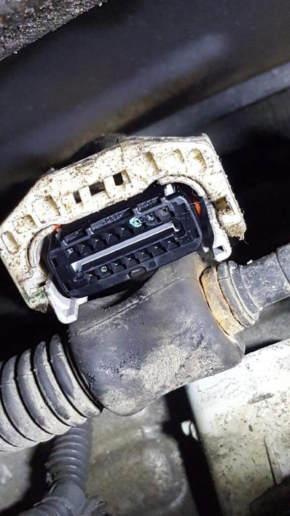

    Here is what happens when water gets into the pins at the wiring harness.
    We call it green death in the transmission trade.
    Water will leak into the pins and then into the switch causing some nasty issues .
    The first thing you see is loss of connection and a code is triggered .That nice green light on the dash doesnt illuminate when you are in drive
    All that green crap prevents the pin ( wiring ) from a proper connection .
    If you catch it quickly and clean the corrosion and re-seal , you may get lucky but its a massive pain in the @ss to work on the range sensor while its in place .
    That green crap doesnt clean up like new . Usually takes out the male and female portion of the pin and the wire . Believe it or not but baking soda is best for cleaning this . Rostra makes harnesses if you want to save from buying OEM. Get ready to solder and heat shrink for hours .
