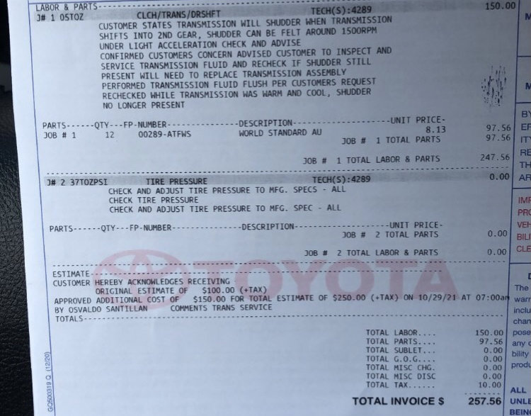

    Was having the 2nd gear shudder. But it also persisted in 3rd gear at low acceleration. The "Shudder" was at first noticeable but the next day became heavy and consistent. I took the day off and took the truck directly to the dealership. My friend works at this dealership and always takes care of me. But hes the type that if you're not having an issue and the maintenance manual doesn't direct a transmission fluid drain and fill or a flush for that matter. Then theirs no need to have it serviced. I know per Toyota these new vehicles have a "Forever" transmission fluid that never needs to be changed and I really think that's BS. My friend did say some of these 3rd Gen Tacomas the 16's and 17's came with low trans fluid from the factory.
    When my friend drove the truck he was shocked that the truck was shuddering pretty bad. He had the Master Technician/Foreman whatever you want to call them drive the truck. He agreed it was the "Torque Converter Shudder/Flex. He stated that if the Flush and Fill doesn't fix the issue I would need a new transmission. They kept the truck overnight, they had to drive the truck in the morning cold and check the level. Sure enough the torque converter ate up some more fluid. They refilled to level and the issue was solved. I hope this helps anyone that is going through the same issue.
    My truck is a 2017 4x4 Off Road with 128,000 miles. I will add a picture of what was written and done.
