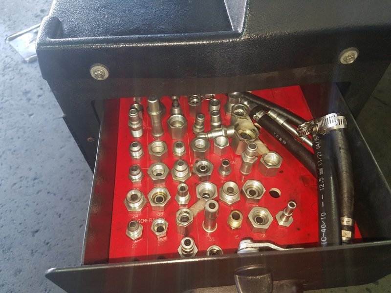

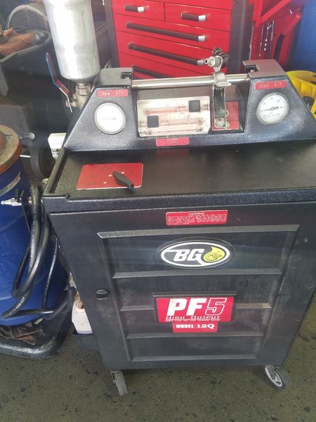

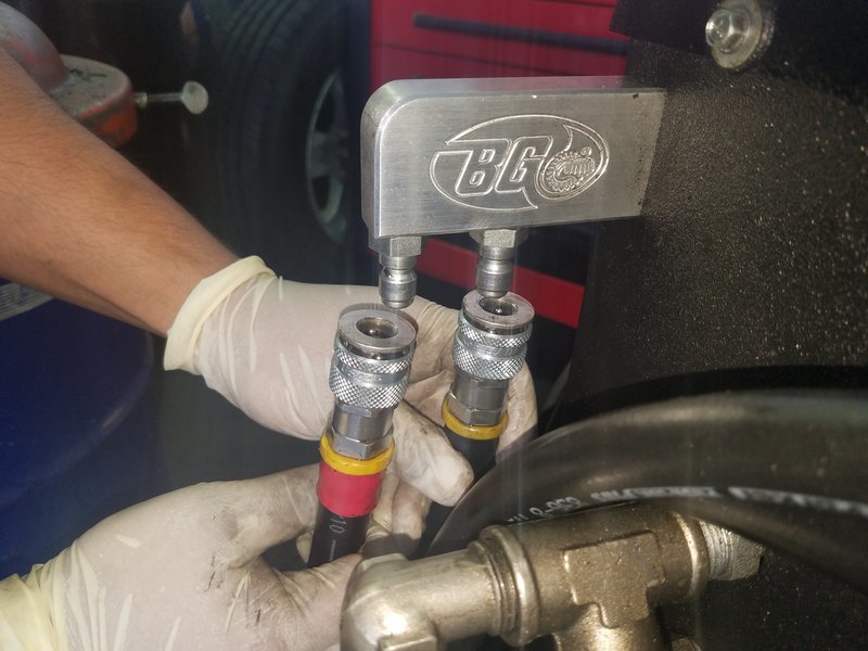

  9. Mar 13, 2017 at 2:29 PM
    #29
    MonkeyProof
    MonkeyProof Power Top
    Oct 7, 2008
    #9774
    12,821
    SoCal- SGV
    These are the machines that we use. The main 2 hoses are quick-connect which are the same size. Then there are the specific adapters ...
