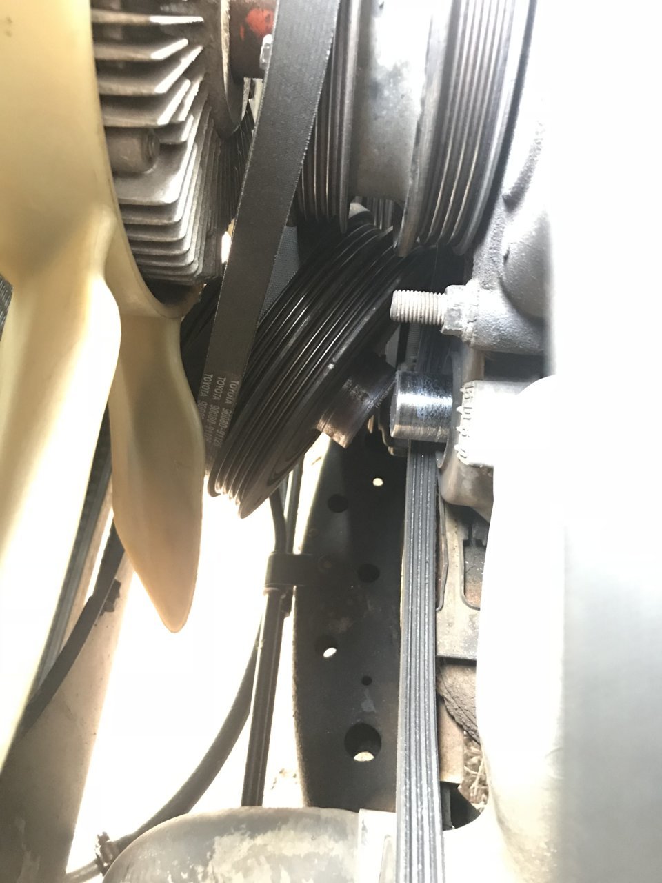

    I took this picture when the balancer fell off.
    I don’t know if you can tell anything from it...

    The end of your crankshaft did sustain damage. It's visibly apparent in the picture.

    For this engine, I don't know for sure if the thrust washers failed or maybe the thrust bearings, but what I do know is this engine is done. Here's two videos I made documenting this problem.
    In this first video, watch how the harmonic balancer juts forward as the engine starts.
    https://www.youtube.com/embed/uxvXicCba6o
    In this second video, we confirm the play is definitely coming from play in the crankshaft.
    https://www.youtube.com/embed/9Gpdq-tL79U

    When I helped out someone who had the same issue as the OP, it's not that the harmonic balancer wasn't fitting the crankshaft properly. It would have fit if the crankshaft wasn't damaged from the harmonic balancer spinning on it creating an uneven rigged surface not allowing the balancer to slide on. So, I suppose you could have taken the balancer to a machine shop to bore it out but I believe addressing the unevenness of the end of the crankshaft was a legitimate way to fix the issue.
