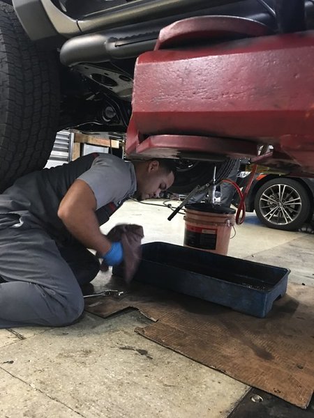

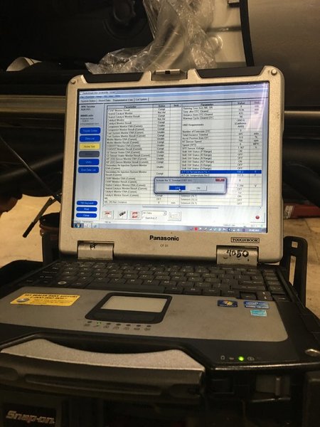

    Well. Went to the dealer today and they finally checked the fluid and it was half a quart low just like I suspected. I haven't had the chance to start it from cold but after I left the dealer the transmission seems much smoother and the cruise control keeps thE highest gear. I will report once I start it from cold but if you have issues with erratic transmissions please get it checked. Many friends with previous tacomas models and 4 runners have also had issues with low ATF and erratic transmission changes and shudder. Please get your tranny checked asap.

    Exactly the same thing mine is experiencing. Take your truck to the dealer and have it checked for proper ATF, mine was missing half a quart and it was filled yesterday. I have not started it from cold since yesterday so i cannot vouch that the problem is completely gone, what i can say is that the 10 miles i drove from the dealer to my house the truck behave differently in a good way, shifts are smoother and the cruise control is not hunting for gears as before. I am reading in another forum that apparently there is a software update for the tranny coming up soon, I asked my rep at toyota, master mechanic and he told me he hasn't heard anything but what he can tell me is that these new transmissions since they are smart take a little time to get used to and they have kind of a break in period, also told me the viscosity on this ATF WS used by toyota since 2004 is very light and it takes longer to warm up and he recommended to start the car every morning and let it warm for at least 1 min. Hope it helps but please get your ATF checked
