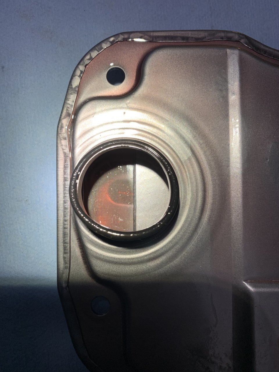

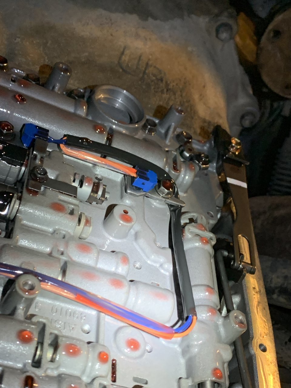

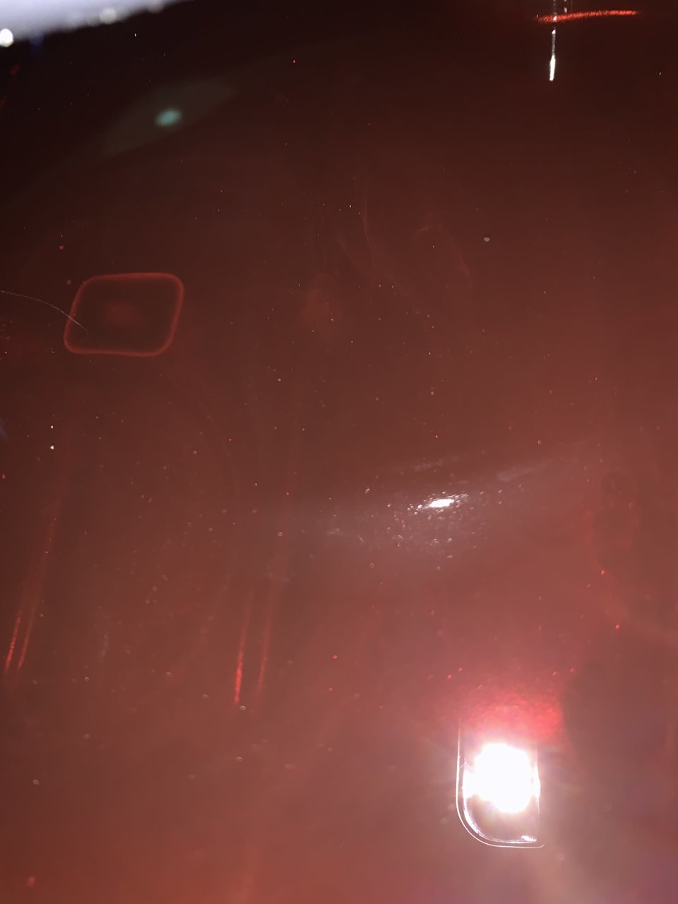

    Status update:
    Converter spins freely behind the flex plate. Not much noise.
    Filter looks to be lightly 'seasoned'
    I looked at the internal harness for damaged wiring. This bend was the only section that looked strange. Nothing looked visibly broken. I have a new harness on hand that I will likely swap in.
    I took some more photos but they weren't very good. Either extremely glared or completely dark.

    A little too much metal in that transmission pan and filter .
    Do you know the mileage on the transmission
