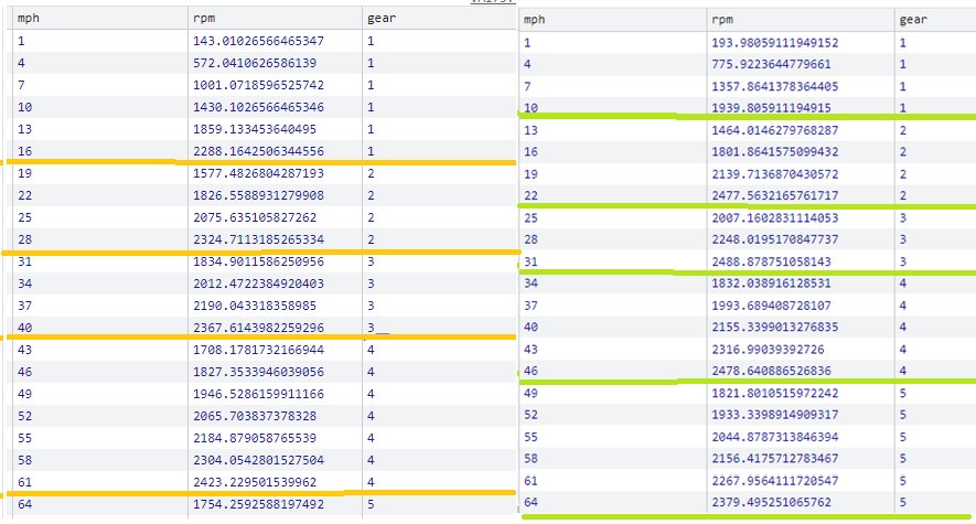

    I've had a lot of new trucks recently because I didn't know what I want. All the new stuff has a laggy trans. Nothing more disappointing than stepping on the gas and getting no torque. I get this in the Tacoma and got it in the others with way more power.
    Still I think the cruise control is almost unusable for towing in the Tacoma. Terrible experience. But getting my regear soon, and hopefully this will fix it. I calculated 2500rpm shifts with old gears and 5.29
