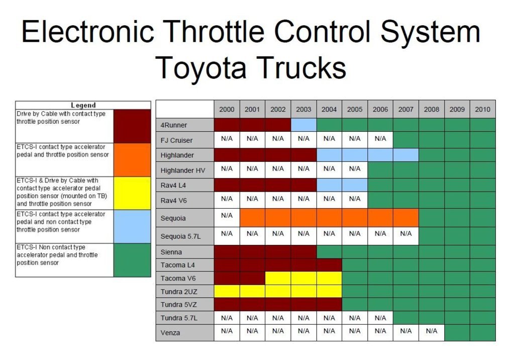

    Yup, don't forget the rear driveshaft, trans mount, bolts, and fluids. Gear position sensor between even tacos is different so I would assume sequoia and tundra would be further still. Also trans varies between cable driven or electric, so at least know which you have
