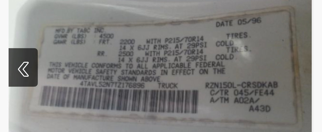

    This is a VIN sticker from a 1996 2RZ 2.4l Auto just like yours. Look at the lower right hand corner, it says A43D. That is the transmission you should have. Can you confirm your sticker says A43D?

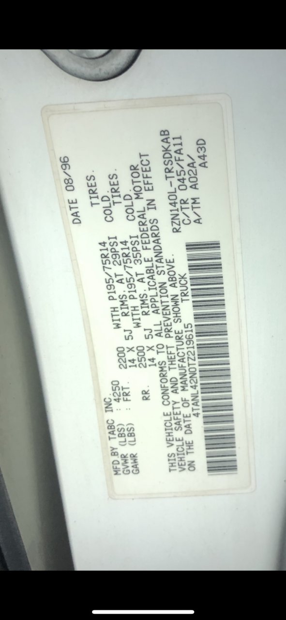

    @BartMaster1234 I got the pic and yes it says A43D. I’m not sure why car-part.com showed me this one tho? Even the guy at the salvage yard said it was a direct bolt on. Thank god I got the 90 day warranty lol I’ll go swap it out Monday.

    Word of advice, don’t trust what salvage yard people say. lol.
    The A43D and A44D are unique to the 5-lug chassis. The A340E was solely used on the 6-lug chassis.
