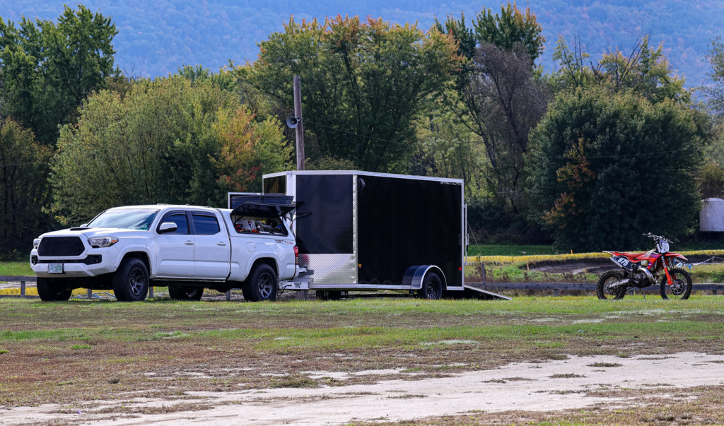

    Curious as to what your trailer, terrain and outdoor temps were like to get to 230*. We never made it past the high teens (~218*) with a 3k lb trailer and loaded truck on I70 (Colorado) and I77 (West Va.)

    7x12 Aluminum v nose. It's not heavy, just a brick in the wind. Rolling hills in Vermont sometimes has me down into 3rd to maintain 55mph. IMG_6180.jpg
